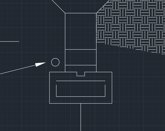

As im moving into sheet 2 i was just wondering if im just copying the layer1 to layer2 and adjusting paperspace to reflect each different sheet or if im meant to make each of these sheets a completely separate file? The directions dont really say much in the way of that, or if it even matters.
Each "plate" is meant to be a separate drawing.
@ReMark Ah dang okay yeah i just sorta moved over in the model space and then copied layer1 to a new layer and then adjusted. I guess ill continue this way and then at the end import these into new files to separate them.  Thanks!

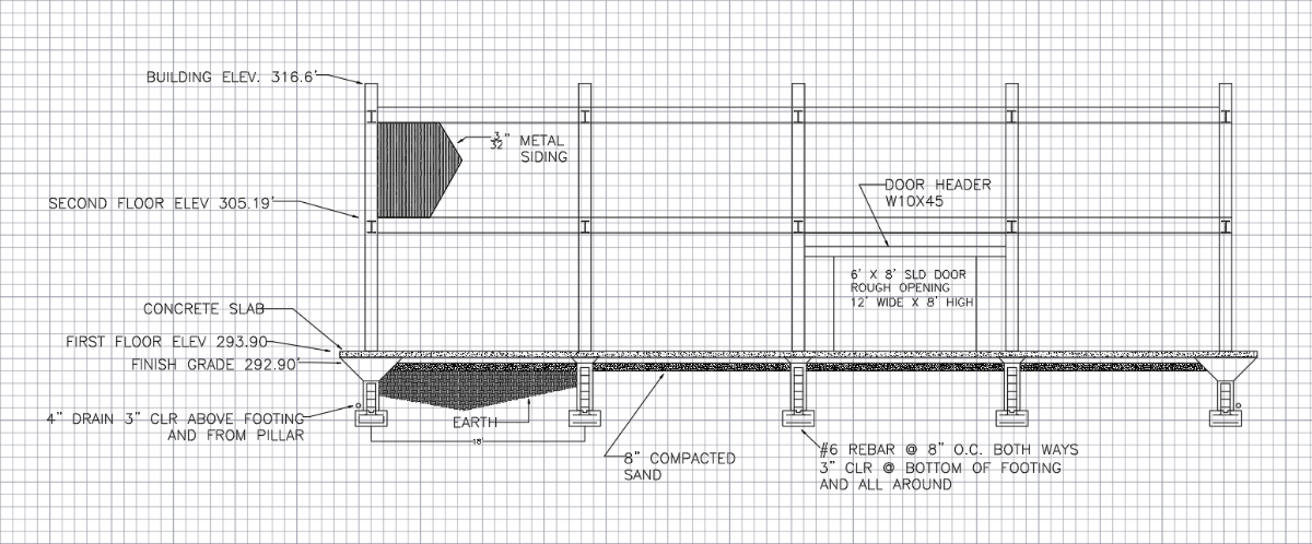

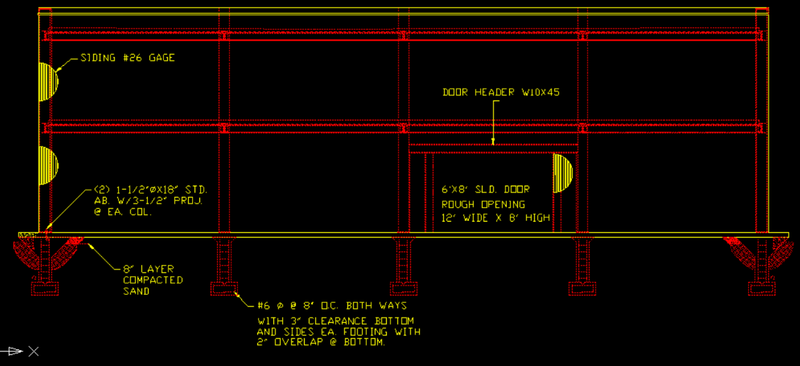

@ReMark I am having trouble understanding the rebar for the footings in this sheet 2 elevation.
Vertical and horizontal rebar is placed in the pier. notice how the rebar from the pier extends down into the footing-- use the same detail here but space the horizontal rebar at 8" centers. The overlap detail at the bottom of the rebar is 2" long.  This rebar is #6 rebar at 8" OC.
My best guess is that from the very bottom of the footing, to the top of the pier before it angles, there is 8" OC rebar horizontally and then vertical rebar that i cant seem to come up with anything for other than maybe its 3.5" away from the edge of the pier
Please refer to page 2 of this thread.  Scroll all the way down to the bottom then go up two posts.  There you will find an image of a concrete pier and footing detail I created that works for this project.

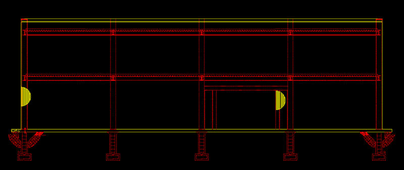

@ReMark idk if youd be open to giving these screenshots a quick peek, im struggling with this project for a while now.
sheet 2
@remark

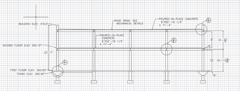

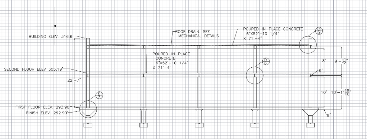

I feel like im overthinking sheets 3 and 4 as far as the thickness from the top of the W12x40 girders to the top of the poured in place concrete of the second floor.
I have referenced the drawing i could find of these section views i just think my interpretation of them and the instructions are off somehow.

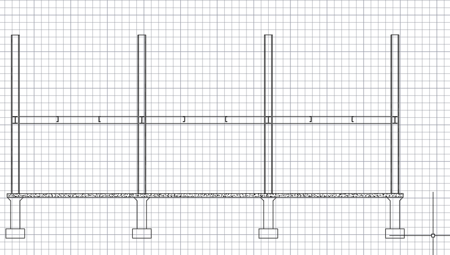

Sheet 4 im just starting now and then i have three more.  This project has taken so long just because of work, i have until november 20th and to get the rest of the course done seems doable, this project has just been ridiculous to understand
I have all these in one .dwg file by the way, i was going to get through the drafting and then copy the files, separate them, adjust my paperspace and then rename the file and do the layers at the end of all of this.
Also, If in Section A, we see the W12x152 vertical beams connect to W12x40 girders as well as the C channels, the top of the channels to the second floor elevation wouldnt come to 6" unless im misunderstanding something.  the clear distance of the first floor to the ceiling of the first floor is 10' and i cannot for the life of me make sense of everything between the ceiling of floor one, and second floor elevation 305.19'.  Ive really tried not to bother anyone with this given the ocean of info in here already, but im coming to my mental capacity for this project at this point, and have another 6 plus an apparent extra one ive heard about.  Any guidance would be greatly appreciated, thank you so much.
