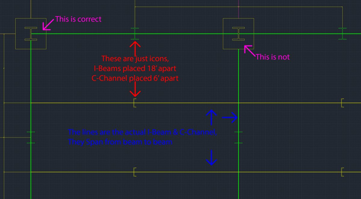

Firstly this instruction right here has totally thrown me for a loop:
"Running horizontally between adjacent girders are 24 steel channel beams. There are two channel beams in each 18′-0′′bay, and they’re spaced 6′-0′′apart. The beam designation is C9× 20, and its dimensions can be found in Appendix H. The channel beams rest on the bottom flanges of the girders. There’s a 1′′gap from the web of the girder to the end of the channel. Put these channel beams on layer C9× 20, with a yellow color and a continuous linetype."
The girders are supposed to be spaced 18' apart, so how can the channel beams possibly rest on them with a 6' spacing? To test this out I rested a channel beam onto the bottom flange of the girder with a 1" space from the web then arrayed it, and here is how it came out:
image of my work
You can see that one of the chain beams is simply floating in unattached to anything.

1. If you do not have Appendix H then contact your course instructor and ask that it be emailed to you.  Appendix H contains dimensional data for the beams and channels you will be drawing as part of the structural project.  Don't ask me for the appendix as I wasn't a student.  However, dimensional data for structural steel shapes can easily be found on the Internet with a simple search.  Try this website for starters: http://www.structural-drafting-net-expert.com/steel-beam.html
2. Re: channels.  The C9 channels run horizontally between the W12x45 girders.  They do not run vertically.  The W12x45 girders are bolted to the W12x152 columns using the L4x4 clips.
3. The L4x4x1/2 clips are 6 inches in length.  The clips are bolted to the web of the C9 channel as well as the web of the W12x45 girders via two bolts per angle leg (for a total of four bolts).

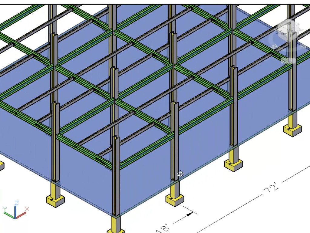

I've got the elevation plan basically complete and have started working on section A. Still very confused on where the girders and channel beams are supposed to be located in both the elevation and section plates. If you look at the cutting line for section A on the foundation plan and use that as your basis, the girders should in theory be spaced 18' apart just like they are in that plan right? And the channel beams should be 6' spaced as they are in that? So why are they not drawn like that in people's images posted on here? It's not that important in the elevation as they are mostly there for reference, but in the section view, you are to draw ceiling tiles underneath the channel beams so the layout has to be right on them.
Edited by JimJames1978
Yes, the girders are spaced 18' on center to match up with the columns.  The 6" channels run between the girders in a east/west direction.  Every student who has drawn them this way has passed the structural project.  None of the structural elements are there solely "for reference" as they form an integral part of the overall construction of the building.  Perhaps your A & B cut lines are incorrectly located or you are misinterpreting the instructions which is understandable given that it is not Penn-Foster's intent to teach structural drafting.  They are attempting to teach AutoCAD although they don't even do that very well.
Plate 1 in a since is just a top down view of the structure. Yes the girders are spaced 18' & channels are spaced 6', however they are just illustrations not actually vertical...
To understand this easier here is a screenshot of the 3d render posted here...
1061707362_555b4ab4-f1d6-4bf2-8680-148b0a29499f_653484c3-c963-455e-a8f0-042ba7cfd126_static_0_0_Structuraldrawing.thumb.jpg.aacdc93ccd580e4335bbc03d840e05ea.jpg
As far as the dimensions, all of your subsequent drawings should represent what you have in plate 1. So one plate 2 is just the view from the south side of the building(southern elevation) so on and so forth.
