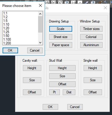

Ok try this load radiobuttons4  1st, this is a bit rough and not properly tested, you can make a new version that is 3 radio butons by removing the repeating lines that make the total number of buttons see val1 val2 etc
(if (= TOG "S")
   (if (not Ah:Butts4)(load "Radio buttons4"))
  (AH:Butts4 "Choose Top Centre Bottom X " "T" "C" "B" "X")
      (cond ((= val1 "1") (setq PT1 PT1B))  ;top
           ((= val2 "2") (setq PT1 PT1))   ;center
         ((= val3 "3") (setq PT1 PT1A))  ;bottom
       (setq val1 nil val2 nil val3 nil val4 nil)

There is a lot of stuff here that could be changed, some would be user preferences for me the menu has all the beam sizes info I would have that in a text file. Using a dcl you can call sub dcls so the obvious is to take advantage of this and have a top dcl with simple example BEAM, COLUMN which opens another dcl where you could select the type of Beam I, Round, Square. Then a dcl list so you pick.
Some of the (load "start") etc can be replaced with a (if (not "started")) so its not loaded every time, same with the findfile if you add a "steal" directory to the support path then findfile is not required.

Like Grrr its a big job lots of code. I would just improve things one at a time like the initget replaced with dcl's using a couple of library DCL's would cover this easily as I suggested with the radio buttons you can have a routine that accepts as many buttons as you need but its only one program. I have started replacing all get's in my code where possible with DCL with default values. You will see this often in what I post now.
As you mention in the 1990's dcl's were not used much everything was menus and lost of ifs.
I would look at a different approach you may be better looking at current package this would be up to date 2019 etc, it probably has way more than what you want or has stuff that you did want and don't have now.  Have a look at Strucplus others will make suggestions.
If I was to rewrite I would base it around a number of library defuns so code is not continually duplicated, one thing I worked on was user layers within the code so for most it was not hardcoded to what got drawn on which layer, rather a layer variable.
