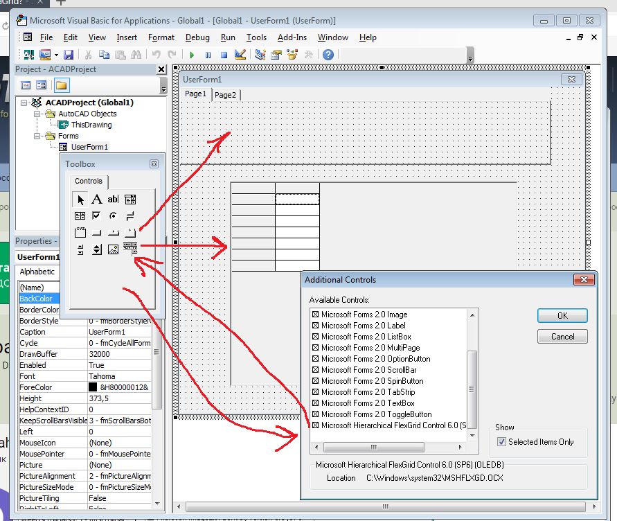

DataGrid control?
VBA for AutoCAD allows a limited number of controls.
I would like to add a DataGrid control and even a menu and toolbar control.
Is this possible?
Thanks for the reply.
I don't see 'Microsoft Hierarchical FlexGrid' in my additional controls - how do I add it?
There are many other controls.
Choose the right one.
If you need this, then
or Microsoft website
or install one of the programs, it is included in the delivery package - https://kdmsoft.net
