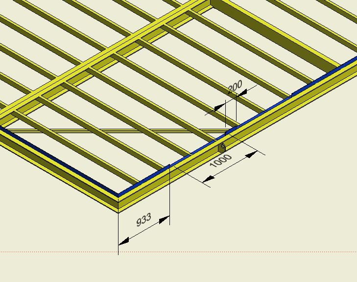

Hi all. This is a beginners question, but how does one ensure that when dimensioning in an .idw all dimensions pull to the same direction/axis? I've tried various methods of selecting edges and dragging all directions but often end up with inconsistencies as shown in the image.
What am I missing?

Ok well if anyone else stumbles upon this topic in search of a solution to the same problem I was able to overcome this issue by toggling between directions using the spacebar before placing the dimension.
