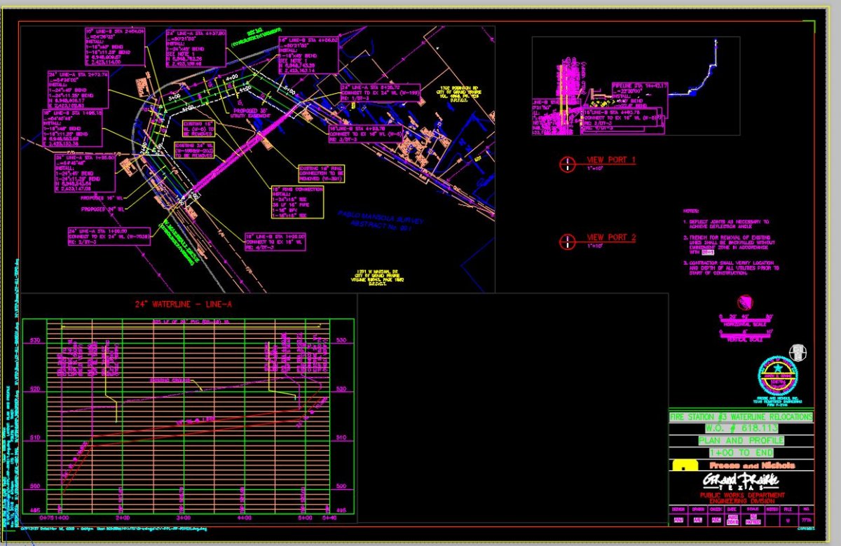

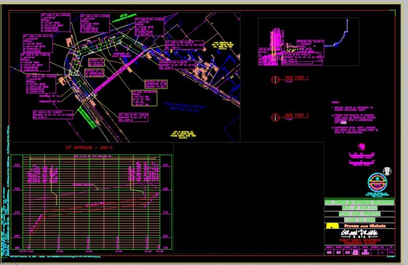

My engineer wants me to create two view ports on two different areas of the waterline. Everytime I do the "MView" command to create a viewport it goes through but then it ask me to regen and my viewport on the bottom right disappears (Pic #2). I try hitting Regen again and it still wont come back. Please help.
1678699054_VIEWPORTBEFORE.thumb.JPG.418062e5fda3295d2a26b9280136586a.JPG2016440076_VIEWPORTAFTER.thumb.JPG.f65b03aaa5b376f2405e73a2ef0ecced.JPG
Edited by Oscar
59 minutes ago, nukecad said:
Maybe the MAXACTVP variable has been changed?
Sets the maximum number of viewports that can be active at one time in a layout.
https://knowledge.autodesk.com/support/autocad/learn-explore/caas/CloudHelp/cloudhelp/2016/ENU/AutoCAD-Core/files/GUID-86846A4D-4E21-4E62-A710-E7B55243452D-htm.html
the MAXACTVP was set to 4 great call 👍 I set it to 64 and problem solved. thank you so much!
