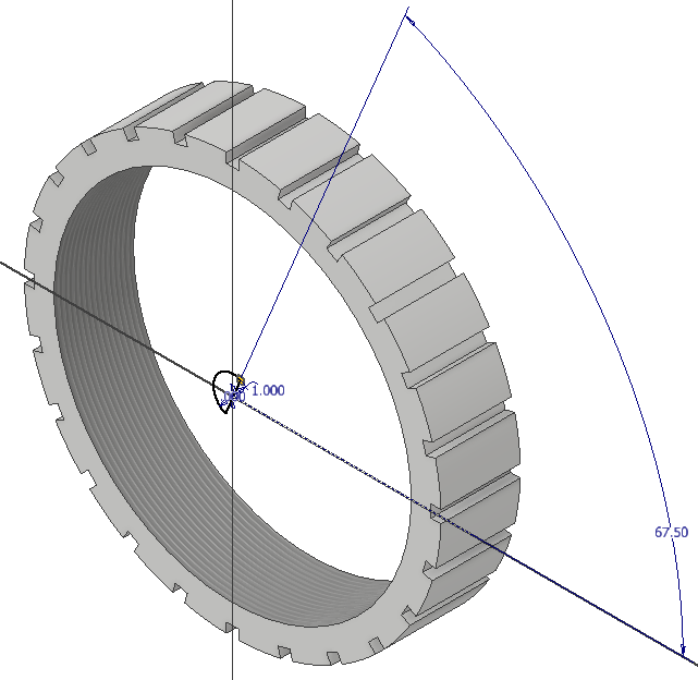

Creating Workplane at an Angle from Origin
How can I create a workplane 22.5° off from YZ Plane?

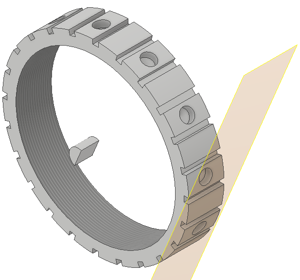

I ended up creating a Sketch with a Flat Face, and then created a plane parallel with the Face Tangent with the outside Diameter.
Then I cut away my extrusion.

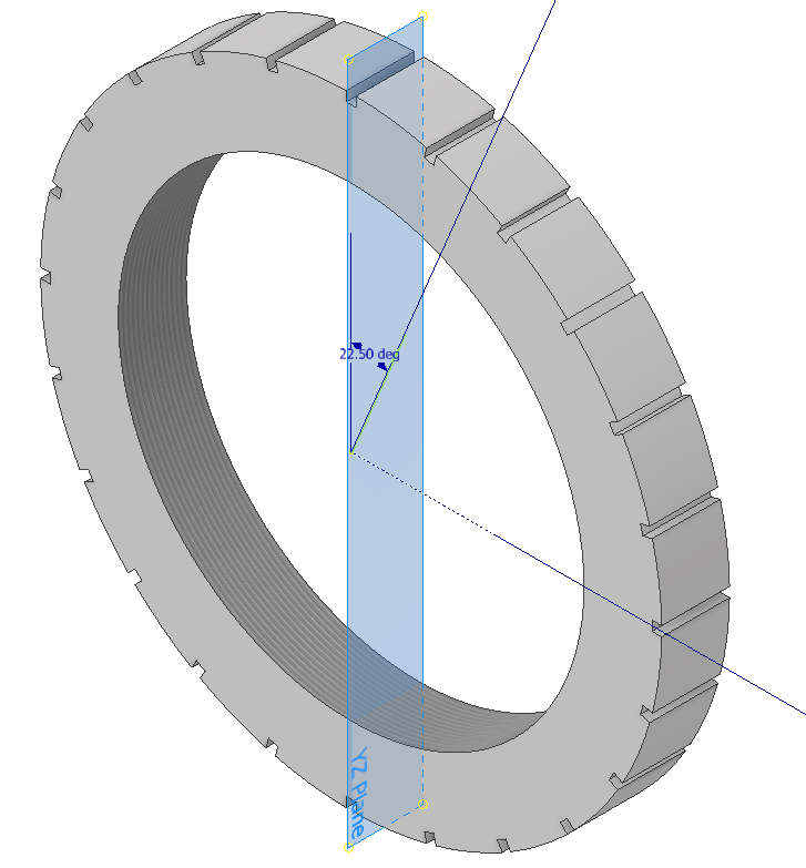

Create plane ► select Z axis ► select YZ plane  input angle.
