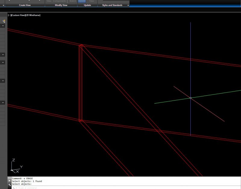

After further investigation of your file, I'm very confused about how you created these polylines? I went into Orbit mode and spun your model around and zoomed in on an intersection and I see your polylines not only have thickness, but also width, see image below. They look more like 3D solids than polylines. So I'm wondering, how did you create these?

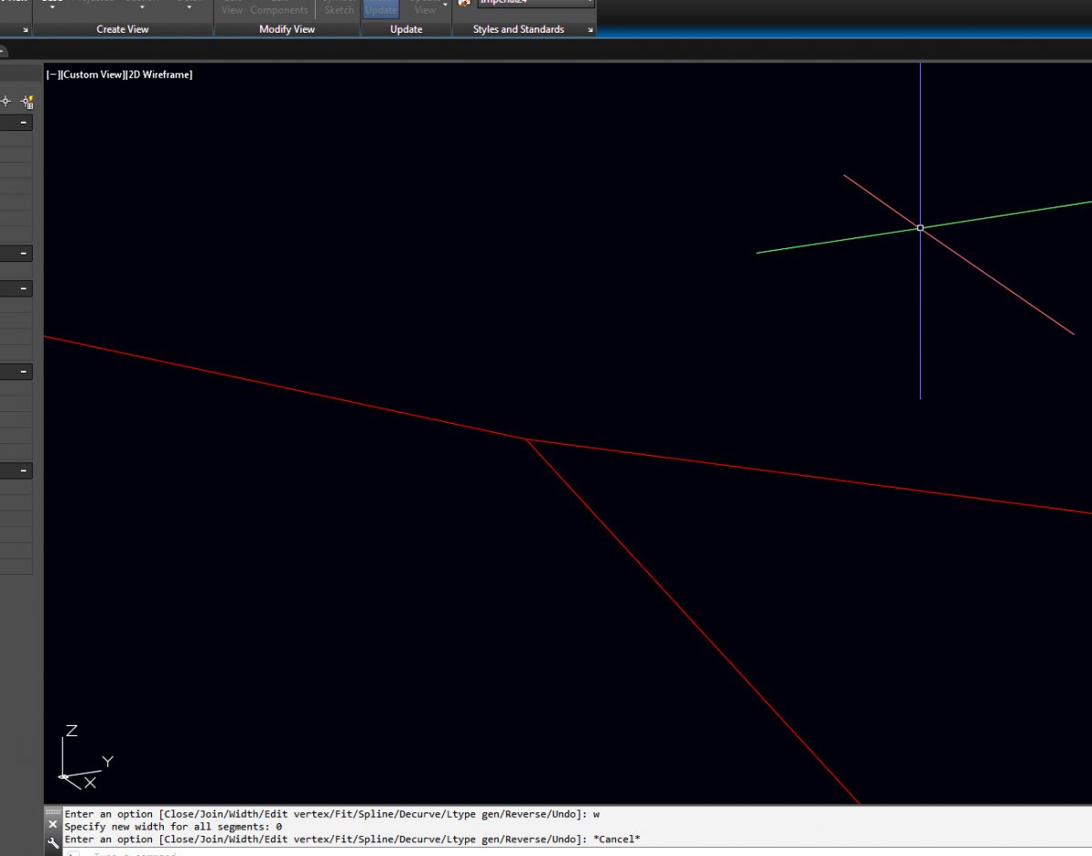

Ok, I just changed the Thickness of the lines to 0 and then ran the PEDIT command and changed the Width to 0 and that finally gave me  simple polylines. Try doing this to all the lines in your file, then import to Watergems and see what happens.
