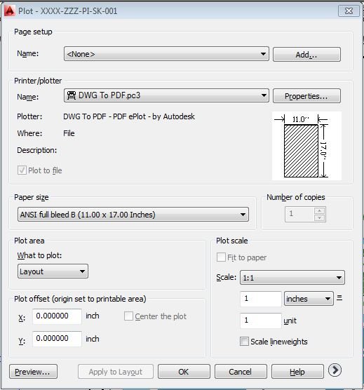

I revised the code as follows:
(defun c:zzz()
      (vl-load-com)
      (if (setq filename (getfiled "Save File Location" ""  "pdf" 1))
      (command "-plot" "yes" "" "DWG To PDF.pc3" "ANSI expand B (11.00 x 17.00 Inches)"
          "inches" "landscape" "No" "Layout"
          "1:1" "0.00,0.00" "yes" "acad.ctb" "yes" "no" "no" "no" filename "n" "y")
This will at least plot, but it is shifted off to the right (see "2018-141-PI-SK-001.Lisp.pdf").
However, when I plot it manually it comes out correct (see "2018-141-PI-SK-001.Manual.pdf").
See the plot settings used.
How do I adjust to code to get it fixed?

The dialog and the Lisp code show different page sizes:
"ANSI full bleed B (11.00 x 17.00 Inches)"
Expand
@ eagle eyed Roy.... totally overlooked this. My first reaction would have been to use the full bleed size but when I saw OP was using this in his dialog and said he used exactly the same settings overlook this... so be aware  roy_043 sees everything 😁
Expand
That was it!  I just ran a test and it came in like I wanted.
You guys are the best!
