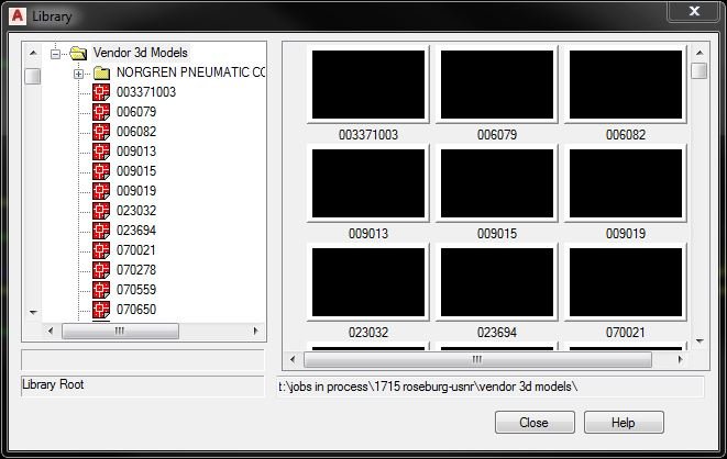

cadmando-2 Posted October 17, 2018 Posted October 17, 2018 I recently started using AutoCAD AMLIBRARY to link our Vendor 3D blocks and custom blocks, but our main engineer/IT wants us to start using XREF. I search the web for XREF utility like AMLIBRARY and unable to find anything. Does anyone know of a robust “External Reference manager utility” lisp routine that is similar to AMLIBRARY? Quote

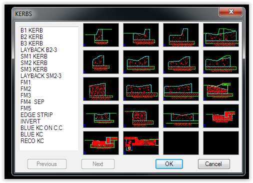

BIGAL Posted October 18, 2018 Posted October 18, 2018 (edited) Probably the best way is to use tool palettes, I am old fashioned and use menus, you can also use a custom Dialouge via lisp. Some one else will provide more info than me for Tool Palettes. The image posted is using menus and can have a lot of items as the next button works. Edited October 18, 2018 by BIGAL Quote
