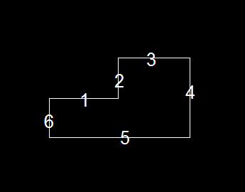

How If I want to Extport Dimension of an autocad object to excels? (sorry, my english not good)....
Thanks
Irawanaja, my English is not good too.
And accordingly I did not understand.
What do you mean when you say Dimension?
AutoCAD Dimension object 46f18fb24fb1.jpg or a length of object, such as line, or polyline?
Tanks to your time Geobuilder, i mean length of object and the text of the object and i want to sort all to excels, like this image
1. The figure shows a polyline or lines ?
2. Marked text will always be in the middle of segment?
Edited by VVA

Where are the Coor, CoorN and CoorNP commands?
the figure shows as polylines and / or lines (both) and the marker texts does not always in the middle of segment, i want to use the marker texts as sign where the lines / p. line if the dimension exsported to ms excels. tks
