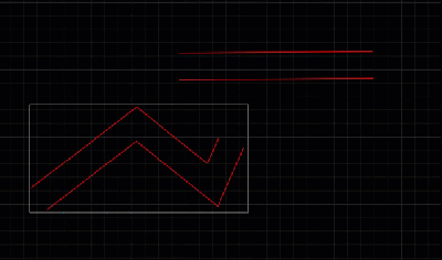

marmo Posted October 16, 2018 Posted October 16, 2018 Hallo, I need to change the justification of various mline, that i have in an old drawing, withou changing the position of the mline, like the command TJUST for text. There is a lisp for that? Thank you! Quote

marmo Posted October 17, 2018 Author Posted October 17, 2018 Thankyou dlanorh but the lisp not useful for my purpose because when you change the justification the mline moves accordingly to the new justification. Instead I would like to change the justification without moving the mline. That is the problem. Quote
marmo Posted October 17, 2018 Author Posted October 17, 2018 On 10/16/2018 at 4:31 PM, ronjonp said: Post an example drawing. Hi ronjonp, I think that it's not necessary. To verify that is enough: 1) draw an mline 2) open the properties panel 3) look at the justification row at the bottom of the properties panel 4) change directly from the panel the justification of the mline (you have 3 possible choises : Top, bottom, zero) 5) when you do that you see that the mline moves accordingly! The question is to change the justification point and keep fixed the position of the mline. Thankyou :) Quote

dlanorh Posted October 17, 2018 Posted October 17, 2018 (edited) On 10/17/2018 at 1:02 PM, marmo said: https://forums.autodesk.com/t5/autocad-forum/changing-mline-grip-to-center/td-p/7183627 This one shows more or less the question I'm writing about. At the end they say that is not possible to change the position of the grip whitout changing the geometry of the mline. Is it ALWAYS true? There is a way via lisp to solve the problem? For example for texts you can use the both ways, you can change the grip position with or without moving the text. Expand Changing the justification of a mline changes the geometry of the mline since the mline coordinates remain the same no matter the justification; and the grips remain at the vertices. The lines change to accomodate the new justification. You can extract the mline coordinates, its current justification and width (MLineScale property). It may then be possible to draw a pline through the coordinates, offset that by the required distance for the new justification and constructing a new mline using the coords of the offset line with the required justification; or simply write the new coordinates back into the existing mline and change the justification. Having never done that, I couldn't say if the new mline would exactly follow the old mline. Bottom justification is always to the right of the direction in which it was constructed. Edited October 17, 2018 by dlanorh Quote
ronjonp Posted October 17, 2018 Posted October 17, 2018 Maybe a hack like this .. definitely works with two point mlines: (defun c:foo (/ a b i o s) ;; RJP » 2018-10-17 (cond ((setq s (ssget ":L" '((0 . "mline")))) (foreach x (vl-remove-if 'listp (mapcar 'cadr (ssnamex s))) (setq o (vlax-ename->vla-object x)) (setq i (vla-get-justification o)) (vla-getboundingbox o 'a z) (setq b a) (vla-put-justification o (if (< i 2) (1+ i) 0 ) ) (vla-update o) (vla-getboundingbox o 'a z) (vla-move o a b) ) (sssetfirst nil s) ) ) (princ) ) 1 Quote
ronjonp Posted October 17, 2018 Posted October 17, 2018 Here's a version where you can choose the justification: (defun c:foo (/ a b c d i o s) ;; RJP » 2018-10-17 (setq c '("Top" "Zero" "Bottom")) (initget "Top Zero Bottom") (setq d (cond ((getkword "\nEnter justification [Top/Zero/Bottom]<Top>:")) ("Top") ) ) (cond ((setq s (ssget ":L" '((0 . "mline")))) (foreach x (vl-remove-if 'listp (mapcar 'cadr (ssnamex s))) (setq o (vlax-ename->vla-object x)) (setq i (vla-get-justification o)) (vla-getboundingbox o 'a z) (setq b a) (vla-put-justification o (vl-position d c)) (vla-update o) (vla-getboundingbox o 'a z) (vla-move o a b) ) ) ) (princ) ) 1 Quote

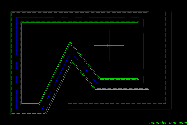

Lee Mac Posted October 17, 2018 Posted October 17, 2018 (edited) You could try my new Multiline Justification program: Edited October 17, 2018 by Lee Mac 2 Quote

marmo Posted November 8, 2018 Author Posted November 8, 2018 On 10/17/2018 at 10:17 PM, Lee Mac said: You could try my new Multiline Justification program: For some reasons it doesn't work in this file. It changes the geometries. test MLJUST.dwg Quote
Lee Mac Posted November 8, 2018 Posted November 8, 2018 On 11/8/2018 at 10:42 AM, marmo said: For some reasons it doesn't work in this file. It changes the geometries. test MLJUST.dwgFetching info... This is not a problem with my MLJUST program, but rather a problem or corruption with the Multiline Styles in your drawing - if you change the MLine justification using the AutoCAD Properties Palette you will receive the same result as with my program. Quote
