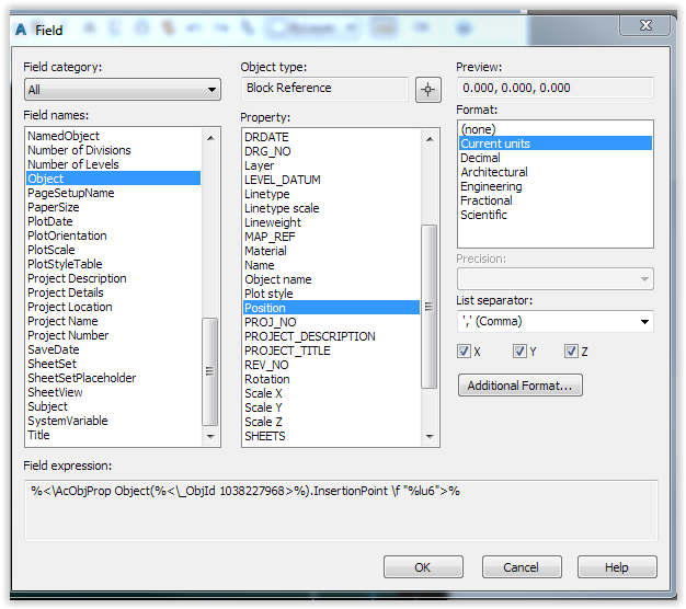

benzson11 Posted October 11, 2018 Share Posted October 11, 2018 is there anyone that can help me create a lisp routine to get: -get the attribute block value (different column) -get position x of a block (different column) -get position y of a block (different column) -then put it on CELL as FIELD. I know that this is possible manually but is there anyone who can create a lisp routine for this. It would be a great help. Thank you in advance, Quote Link to comment Share on other sites More sharing options...
maratovich Posted October 11, 2018 Share Posted October 11, 2018 Attach an example dwg file that you have, and what you want to receive. This will facilitate the understanding of the purpose of the work. 1 Quote Link to comment Share on other sites More sharing options...
benzson11 Posted October 11, 2018 Author Share Posted October 11, 2018 Sorry for the inconvenience that I cause. please see attached dwg file for the example and also attach the lisp routine that i found c/o lee mac. which select a dimension and automatically field the dimension value to the cell. basically that is what i need. i need a lisp routine to select the block and get the position (x)/(y) or northing and easting of the block and field it directly to the cell. thank you again. sample.dwg DIM2CELL.lsp Quote Link to comment Share on other sites More sharing options...
BIGAL Posted October 12, 2018 Share Posted October 12, 2018 A block can return x,y,z etc as a field it is a case of working out the field coding then look at lee's code (setq tStr (strcat "%<\\AcObjProp Object(%<\\_ObjId " (itoa (vla-get-ObjectId Obj)) ">%).Measurement \\f \"%lu6\">%")) a block %<\AcObjProp Object(%<\_ObjId 1038227968>%).InsertionPoint \f "%lu6">% Quote Link to comment Share on other sites More sharing options...

BIGAL Posted October 15, 2018 Share Posted October 15, 2018 Try this it has two parts the make table if no table in dwg and I have tried to get something close to what you had. You can add to a table or make a new one. x y block - table.lsp Table create2.lsp 1 Quote Link to comment Share on other sites More sharing options...
