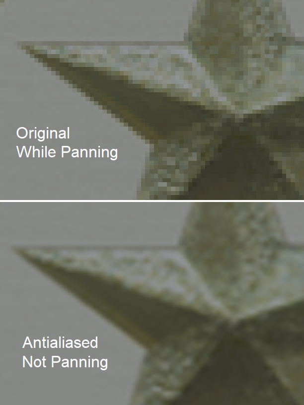

benhubel Posted October 8, 2018 Share Posted October 8, 2018 Often, when drawing geometry, I will use a Raster Image as reference to trace over. By default, AutoCAD blurs the image with some sort of anti-aliasing to smooth out the hard pixels. I want to turn that setting off. When I am panning (with RTDISPLAY set to 0) , the image temporarily reverts to the original image, which is what I want to see all the time. Is there a setting I can change to bypass the anti-aliasing to view the pixelated version while not panning? Quote Link to comment Share on other sites More sharing options...
f700es Posted October 9, 2018 Share Posted October 9, 2018 Can we see an example of this? I find it often depends on the resolution of the raster image. Quote Link to comment Share on other sites More sharing options...
benhubel Posted October 9, 2018 Author Share Posted October 9, 2018 4 hours ago, f700es said: Can we see an example of this? I find it often depends on the resolution of the raster image. Almost all of the images I run into this problem with are relatively low resolution. It is probably worth noting that the effect is not applied to embedded OLE objects, only Raster Image references. I find that I will often pan immediately before drawing a line just so that I can see the features more accurately. Quote Link to comment Share on other sites More sharing options...

Cad64 Posted October 15, 2018 Share Posted October 15, 2018 15 minutes ago, benhubel said: I still haven't found any way to turn off Raster Image anti-aliasing. Does such a setting even exist? I'm also open to alternative solutions utilizing LISP or other types of code. Maybe try changing the IMAGEQUALITY setting? Other than that, I'm not sure what else you can do? 1 Quote Link to comment Share on other sites More sharing options...
benhubel Posted October 15, 2018 Author Share Posted October 15, 2018 2 hours ago, Cad64 said: Maybe try changing the IMAGEQUALITY setting? Other than that, I'm not sure what else you can do? That is exactly what I was looking for. Thank you! Quote Link to comment Share on other sites More sharing options...
