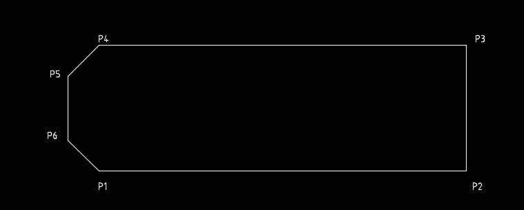

Jim Clayton Posted October 5, 2018 Posted October 5, 2018 Hello again. I'm trying to get started on a lisp but I can't find the groundwork needed to get me in the right direction. I want to create a rectangle, prompt for insertion point (preferably midpoint of on of the sides), X Dim, Y Dim, but only have the corners on one side chamfered to 0.03. That is my starting point. The goal is to then mirror this action in the opposite direction. Anyone able to offer some guidance with this? My lisp skills are currently a work in progress. Thanks for the help. Quote

BIGAL Posted October 7, 2018 Posted October 7, 2018 Just me I work out the points of the pline rather than use a strcat method. In saying that you can have a chamfer on any corner using the method of calculating the pline points, for a rectang pline p1 p2 p3 p4 c, for say 1 chamfer, pline p1 p2 p3 p4 p5 c chamfer is say p3 - p4. Its pretty easy using the polar function. Quote

BIGAL Posted October 8, 2018 Posted October 8, 2018 (edited) You could have multi options and could do something like cnr 1 3 so diagonals only on corners 1 & 3, A for all etc. Diagram above would be 1 & 4 if you use a string input like 1,2 or 1,3 or A or 1,2,3,4 you can pull it apart before you draw. Use lee-marc pasrse csv. Thinking a bit more maybe use vl-string-search and look for 1 2 3 4 A in any sort of input ie 1234 is ok. (setq ans "1234") (if (> (vl-string-search "1" ans ) 0)(setq cnr 1)) start 1st point is chamfer add point to a list. (if (> (vl-string-search "2" ans ) 0)(setq cnr 2)) start 2nd point is -ve from end add to list do vert accordingly (if (> (vl-string-search "3" ans ) 0)(setq cnr 1)) and so on (if (> (vl-string-search "1" ans ) 0)(setq cnr 1)) and so on ; create pline by points from a list (command "_pline") (while (= (getvar "cmdactive") 1 ) (repeat (setq x (length lst)) (command (nth (setq x (- x 1)) lst)) ) (command "c") Edited October 8, 2018 by BIGAL Quote

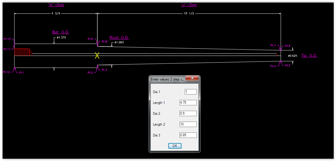

Jim Clayton Posted October 9, 2018 Author Posted October 9, 2018 This might give you an idea of what I'm trying to achieve (attached). coordinates.dwg Quote
BIGAL Posted October 10, 2018 Posted October 10, 2018 Sorry rewrote it entirely using a different method will post again but when I get home thats like 9 hours from now. The code is for a rectang. If you want different shapes it will require a code per shape but the example will show you how. the obvious to me was to have radius instead of chamfer. This is more like a Length 1, Dia 1, len 2, dia 2, but with taper dia 3 needs a whole rethink. Quote
Jim Clayton Posted October 10, 2018 Author Posted October 10, 2018 Yeah my train of thy was to treat it like two chamfered rectangles back to back... the midpoint of where they meet would be the "X" location, treating the diameters as lengths since everything is 2d. Since I'm a noob to lisp though this may have only been good in theory and not reality. I honestly hadn't considered the taper but looking at it now I could see it posing a problem. Quote

BIGAL Posted October 10, 2018 Posted October 10, 2018 I updated the chamfer code above you may be able to use it out of the box.But if you want tapers then may need to invoke chamfer command to save on the maths of a sloping side. Quote
