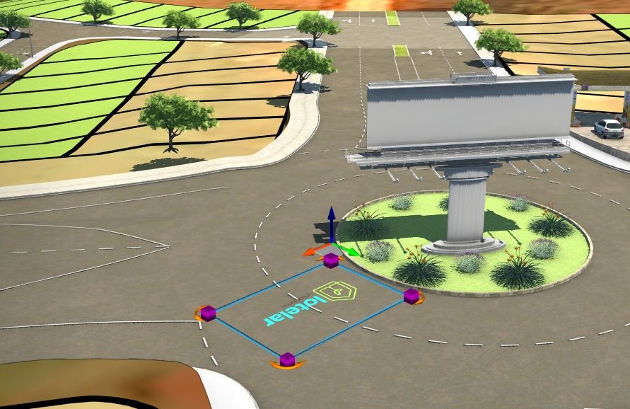

How Can I fix the image, because I couldn't rotate the imagem from Infraworks?
Sorry but I don't use Infraworks, so I don't know. You should try applying the image to the model in 3ds max, as I mentioned in my previous post, and then import the .3ds file again.

Sorry, your thread title says "3ds Max Help", so I thought you had 3ds Max. I guess you will have to find someone who knows Infraworks so they can show you how to apply that image.
