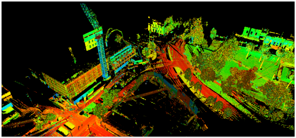

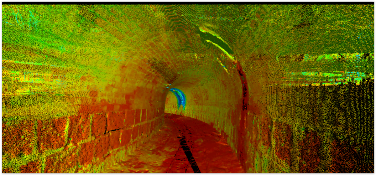

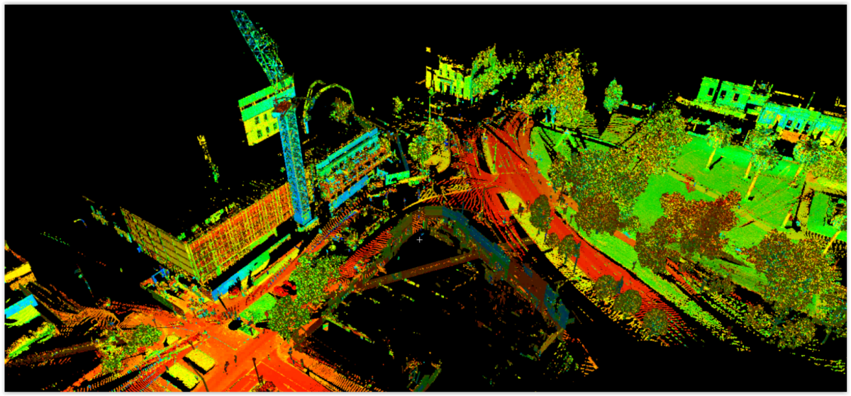

Just thought i would chuck this in here a 632Mb scan above and below underground drain.
