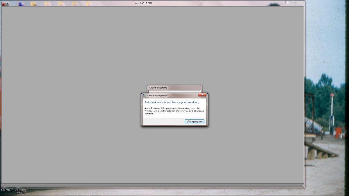

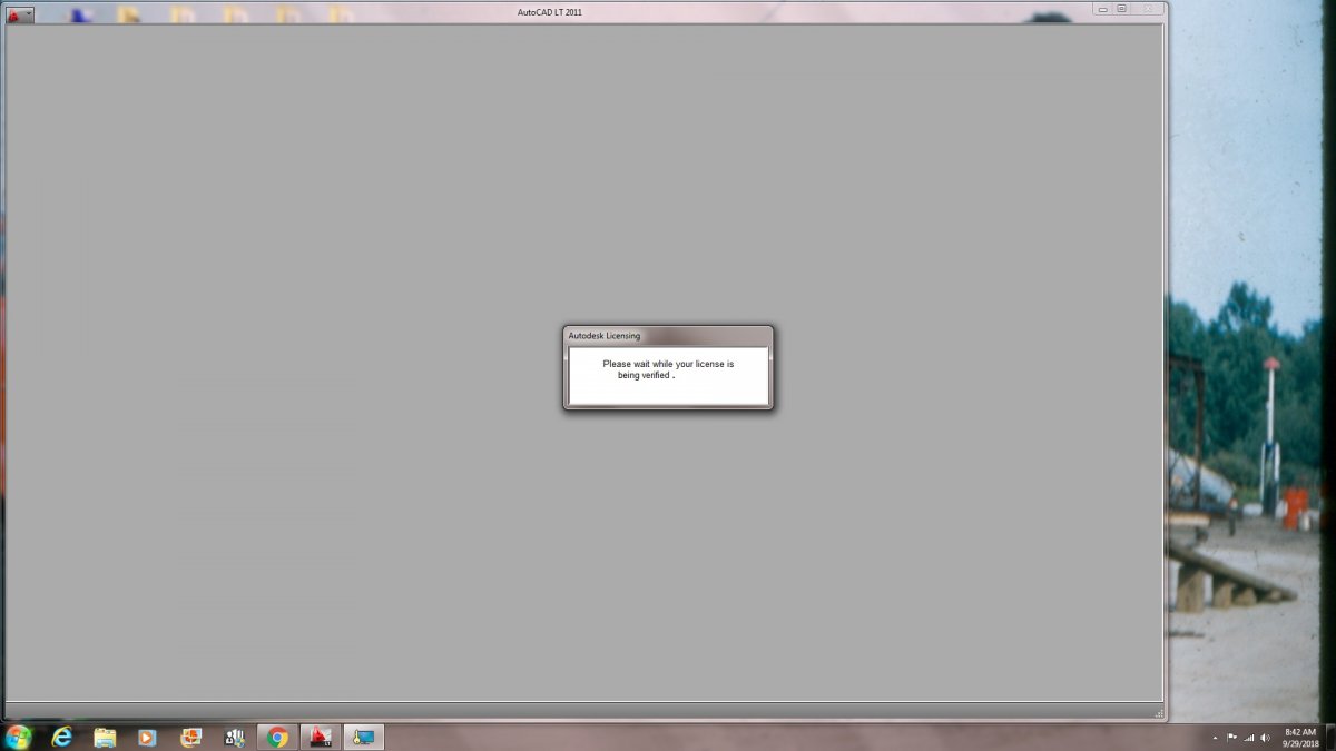

After shutting down the computer completely overnight, I attempted a repair of the installation. Previously, when only putting the machine in to sleep mode, it would not progress and I'd get the errors mentioned in my first post. After the overnight shutdown, the repair progressed what I would deem properly and at the end, I got the message that the repair was successful. When I attempted to open the program, and every attempt  after, I get these 2 dialog boxes.239359177_Cadfaultscreen.thumb.jpg.c6ccd3610fe1a077768a14d436e07cec.jpg1395013051_Cadscreen2.thumb.jpg.3c562dd904c6f5e63af2da82221cd2da.jpg
After every attempt to open, I get an email from autodesk thanking me for registering my product. The new codes they sent me when I first had trouble is a group of 12, while there is a room on the entry box for 16. I don't know if I have both the old and new codes in my operating files somewhere and wouldn't know how to check them if I did.  I wonder if that is contributing to the problem. I don't know that I have the original authorization codes from before this went funky, but do have the new ones issued on 9-25.
It seems I'm very close to having this run correctly and at this point I hesitate to attempt the clean uninstall per the link CAD64 provided; I don't think my knowledge of file manipulation is that keen.  If I have to go that route, I'd prefer someone more savvy than me do it, meaning I'd probably have to take it to the shop.
At this point, it might be best to contact Autodesk, since this seems to be a licensing issue.
