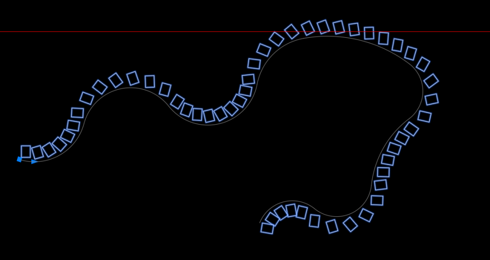

Hello,
Can someone tell me the way do it ? Recreat path of array (path) object.
Thanks.
The example is probably achieve-able. Others may be not.
1st arc pick the 1st 3 left hand insert points
2nd arc pick 3 right hand insert points.
Fillet two arcs with zero rad

Thanks for repply
But if path very hard then i do it ?
If the path was a spline then probably no way. The suggestion i gave was a trial and error, joining arcs and lines.
The simple answer is do not delete the path just freeze that layer.
