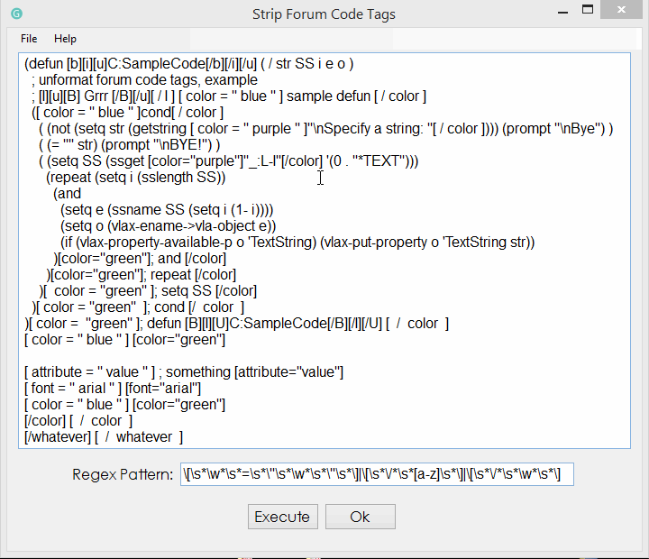

I had the same thought as hanhphuc since the forum updates, about the "old" forum code tags.
However didn't had enough time to practice, but now managed to get some.
So this is a variation of Lee's stripcomments that uses regex (I had a hard time to figure out the regex pattern) :
; (StripForumCodeTags (getfiled "Specify LISP file" (strcat (getenv "userprofile") "\\Desktop\\") "lsp" 16))

And a sample code that I tested:
(defun [b][i][u]C:SampleCode[/b][/i][/u] ( / str SS i e o )
  ; unformat forum code tags, example
  ; [I][u][B] Grrr [/B][/u][ / I ] [ color = " blue " ] sample defun [ / color ]
  ([ color = " blue " ]cond[ / color ]
    ( (not (setq str (getstring [ color = " purple " ]"\nSpecify a string: "[ / color ]))) (prompt "\nBye") )
    ( (= "" str) (prompt "\nBYE!") )
    ( (setq SS (ssget [color="purple"]"_:L-I"[/color] '(0 . "*TEXT")))
      (repeat (setq i (sslength SS))
        (and
          (setq e (ssname SS (setq i (1- i))))
          (setq o (vlax-ename->vla-object e))
          (if (vlax-property-available-p o 'TextString) (vlax-put-property o 'TextString str))
        )[color="green"]; and [/color]
      )[color="green"]; repeat [/color]
    )[  color = "green" ]; setq SS [/color]
  )[ color = "green"  ]; cond [/  color  ]
)[ color =  "green" ]; defun [B][I][U]C:SampleCode[/B][/I][/U] [  /  color  ]
[ color = " blue " ] [color="green"]
[ attribute = " value " ] ; something [attribute="value"]
[ font = " arial " ] [font="arial"]
[/color] [  /  color  ]
[/whatever] [  /  whatever  ]
[b][i][u] [ / i ] [ / u ] [ / b ]
[a] [ a ] [k] [ k ] [ / a ] [ / k ]
that will yield result of:
(defun C:SampleCode ( / str SS i e o )
  ;  Grrr   sample defun
  (cond
    ( (not (setq str (getstring "\nSpecify a string: "))) (prompt "\nBye") )
    ( (setq SS (ssget "_:L-I" '(0 . "*TEXT")))
        (and
        ); and
      ); repeat
    ); setq SS
  ); cond
); defun C:SampleCode
 ; something
So you can get an idea of what "stuff" it gets rid off..
NOTE that one must be careful with the square brackets in his .lsp code, that are usually used within ssget/wcmatch patterns or regex (inception). :lol:
Cheers! :beer:

My 'listp' fix limitation brackets must be 'paired' otherwise error missing or extra parentheses.
@Grrr thanks, RegEx literally fixes regardless brackets not paired.

Written for fun and practice - a windows form project (the .rar contains the .exe file of the program).
Now you don't have to need to run ACAD for just to strip the code with LISP. :)
EDIT:
Updated the program (included a vertical bar, so one could scroll through the code) - I've forgot that they can get quite lengthy :D
Also modified a bit the default regex pattern,
so it would strip also patterns like [color=#87d6ee] or ( previous pattern was looking just for )
ForumCodeTags.rar
