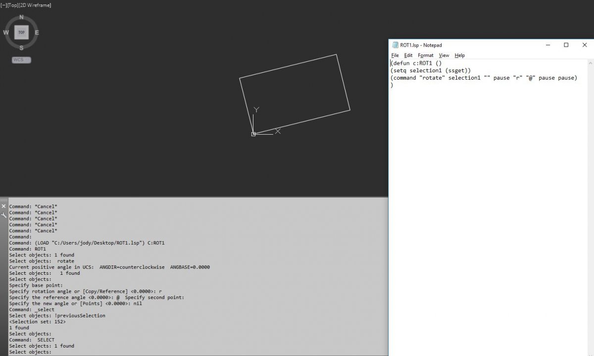

JWhelp Posted September 20, 2018 Author Posted September 20, 2018 Yep, "ROT1" is there in the previous commands list. The command works but i can't get it to repeat with "space" or "enter". Maybe this is a system variable thing then? You both don't have a problem with it. Here's my screen shot showing the command line until the command fails on attempting to run it again. Does this shed light on anything? Quote

rkmcswain Posted September 21, 2018 Posted September 21, 2018 33 minutes ago, dlanorh said: If Its asking you to select again then the lisp IS repeating. Or do you mean you automatically want to select the last object again? No. The (ssget) in the lisp which prompts the user to "Select objects:" is not the same as the SELECT command. Check the image in post 6. Quote

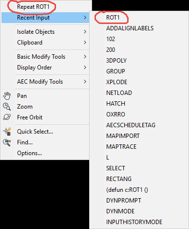

rkmcswain Posted September 21, 2018 Posted September 21, 2018 @JWhelp - try this. Run the ROT1 command and finish it. Then right-click in the drawing editor area, and look at the context menu. Does it say "Repeat ROT1" and is ROT1 listed under "Recent Input"? Quote

JWhelp Posted September 22, 2018 Author Posted September 22, 2018 (edited) Sorry about that! I should remeber to copy from the comand line too, in case someone has a similar problem with viewing jpegs in the future. The image shows that after my script runs, when I press <enter> the SELECT comand runs (Not the ROT1 as expected) My problem was caused by a third party plugin called ' DiLeader ' - which I have now uninstalled. It was supposed to create dynamic leaders with text populated automatically based on what object you were pointing at. It was a bit glitchy and also caused this problem - commands not repeat properly! All good now tho! Edited September 22, 2018 by JWhelp Quote
