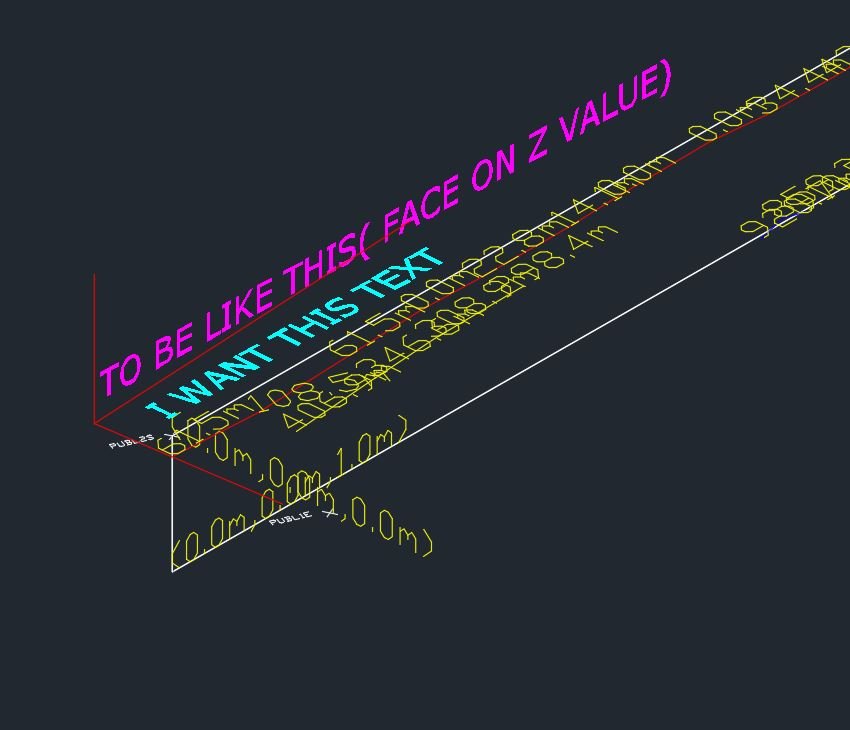

I am struggling to convert couple of text from top view to side view(z face). In this drawing i have 1000s or text heights need to be show from top view to side view.
Is there any quick way i can do it this.
Please see this attached image which will tell you what exactly i want.
Please some one help me.
Many thanks
Biji Samuel
Yes, This drawing i have with 22 3D data and each one contain more than 50 texts.
So is there any LISP Routine for this.
thanks

The other way may be to use rotate3d. The only question is how do you determine the face of the object if its a cube then there is multiple answers. If its single faced then you can get at its properties. If its a 3d face again you can get at the co-ordinates. If its just stand the text up should be able to use the text angle and insertion point.
Maybe a sample dwg.
