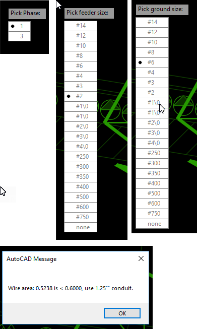

I am think more along the line of rather than setq's like Ronjonp use lists have a look at this uses Lee-mac listboxv1-2.lsp you can get from his website. You have lst2 which is area and using nth num lst2 as below returns the correct area. This saves the # part of strings as your pick list can have # as part of the string. I can hear use pairs in the lists but I have tried to provide a very simple example.
(setq lst1 (list "c0.5"  "c1.0" "c1.25"  "c1.5" "c2.0"  "c2.5"  "c3.0" "c3.5" "c4.0" "c5.0" ) )
(setq lst2 (list 0.1200 0.2100 0.3400 0.6000 0.8200 1.340 1.920 2.950 3.960 5.090 8.000))
(if (not LM:listbox)(load "listboxV1-2"))
(setq num (nth 0 (LM:listbox "pick conduit size" lst1 2)))
(alert  (strcat "You have picked " (nth num lst1) " conduit size\n\nwith an area of " (rtos (nth num lst2) 2 3)))

  (cond	((and (setq a (keyword "MyPipesPhase" "1 3" "Pick Phase" "1"))
	      (setq b (keyword "MyPipesFeeder"
			       (apply 'strcat (mapcar '(lambda (x) (strcat (car x) " ")) l))
			       "Pick feeder size"
			       (caar l)
	      (setq c (keyword "MyPipesGround"
			       "Pick ground size"
			       (caar l)
	 (setq w (+ (* (if (= a "1")
			 3
			 4
		       (cadr (assoc b l))
		    (cadr (assoc c l))
	 (setq d (car (vl-remove-if '(lambda (x) (>= w (cadr x))) l2)))
	 (alert	(strcat	"\nWire area: "
			(rtos w 2 4)
			" is < "
			(rtos (cadr d) 2 4)
			", use "
			(rtos (atof (car d)) 3 2)
			"\" conduit."
Edited by ronjonp
Thanks BigAL, and WOW ronjonp.
You took a simple little program and really jazzed it up with dynmode. That is slick. I've never used that.

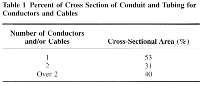

From the code:
;; These ID's seem small? http://www.alliedeg.us/pvc/rigid-conduit/ Wouldn't it be better to use (/ ID 2.) ?
As an FYI, in the NEC, Chapter 9, wire is only allowed to fill a percentage of the area inside the conduit. The numbers used in this program are already calculated for the maximum "useable" area. The wire area can also change depending on the type of wire used. These cross sectional areas are based on type THHW wire, and are taken from a table in the NEC 1993. (We still have that one laying around, the table are easier to read than the newer versions)
For this program, I have used the assumption that each conduit will contain "Over 2" wires per conduit, so only 40% fill is acceptable.
Again, thank you very much for such a nifty program. I'll use this one an toss mine by the wayside.
Glad you can use it! :) .. BTW .. I found an error in 'l2' so please copy the code above again.

Also .. you could add something like this to do the math for you depending on material .. then you can just maintain lists of '((OD ID)).
(defun usable (pipeid #wires)
  (* (* pi (* (/ pipeid 2.) (/ pipeid 2.)))
     (cond ((= 1 #wires) 0.52)
	   ((= 2 #wires) 0.31)
	   (0.40)
(usable  4.975 1)
;10.1083
(usable  4.975 2)
;6.02612
(usable  4.975 3)
;7.77564
Why is 2 wires cross sectional area less than 3 or more?
Edited by ronjonp
Expand
Such is the way of the code books.
From the NEC:
  Quote
Informational Note No. I: Table I is based on common
conditions of proper cabling and alignment of conductors
where the length of the pull and the number of bends are
within reasonable limits. ft should be recognized that, for
certain conditions, a larger size conduit or a lesser conduit
fill should be considered.
Informational Note No.2: When pulling three conductors
or cables into a raceway, if the ratio of the raceway (inside
diameter) to the conductor or cable (outside diameter) is
between 2.8 and 3.2, jamming can occur. While jamming
can occur when pulling four or more conductors or cables
into a raceway, the probability is very low.
Expand
Expand
That is a good idea also. That way, I could change EMT to Rigid, or even flexible (metal or PVC), and then with PVC, there is schedule 40, schedule 80, etc. with differing ID's.
