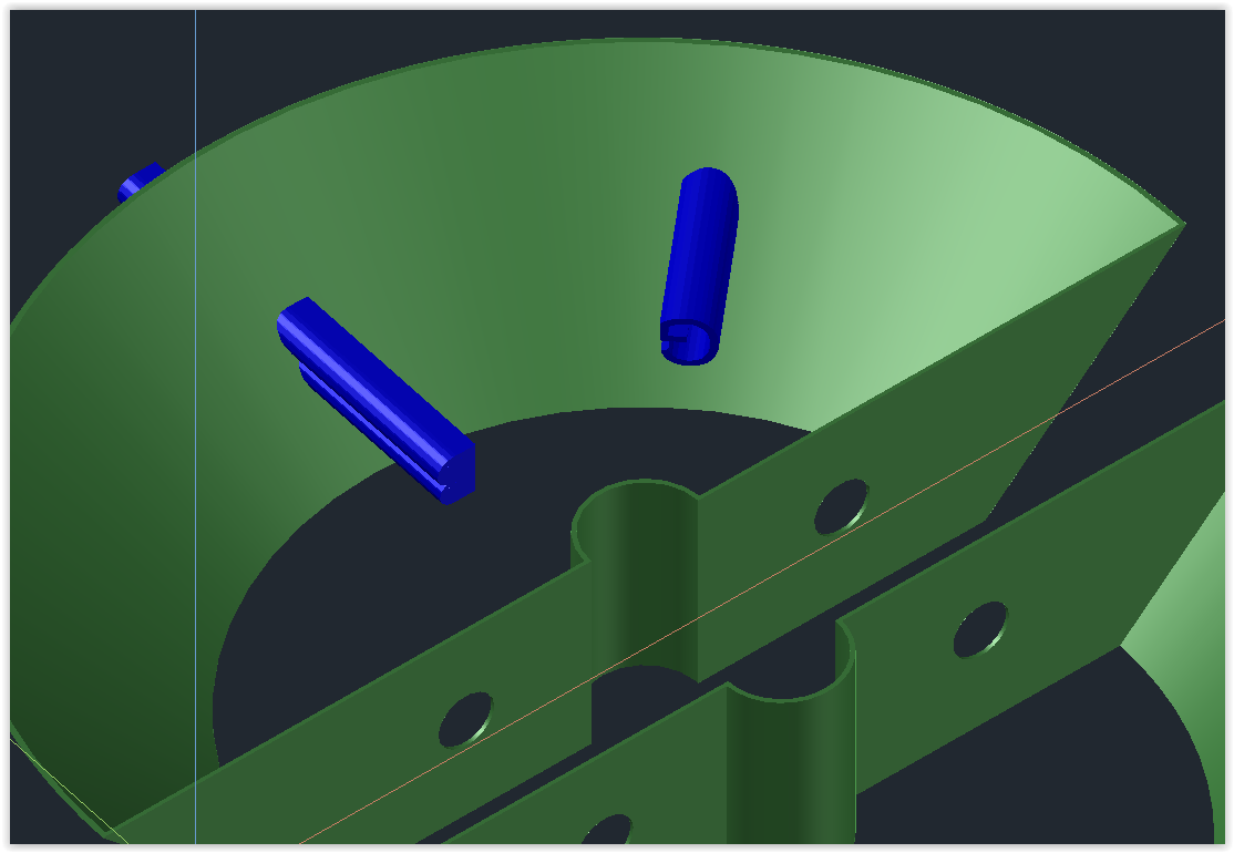

As you know the measurements I struggled a bit you draw a circle say of the 1/2 dia of inside / outside. Then very simply draw radial lines for the text positions use rotate3d to stand the text up use x axis option, it will look like little lines, then rotate sq to  the radials use extrude making bigger than ring, move extruded to say about 1/2 way along the radial need a inside outside of the extrude. Move vertical all the extrudes as they will be at z =0. 0,0,0 0,0,50.
A couple of choices you can subtract the extrudes use an offset from your shape both inside and outside. 3d text will appear. See post by f700es.
If you want smarter rotate in 3d to the slope of object the text will be true 90 to surface when trimmed.

Would it be possible for someone to change the text on the below model. Need it to say Petersfield however once created its not possible to change and as i didn't manage to do this would be great if someone could help.
Cheers in advance.
COLUMN FITTING NAME CHANGE.dwg
There is no editable TEXT in your drawing.(You can proof it easily by exploding the drawing objects).

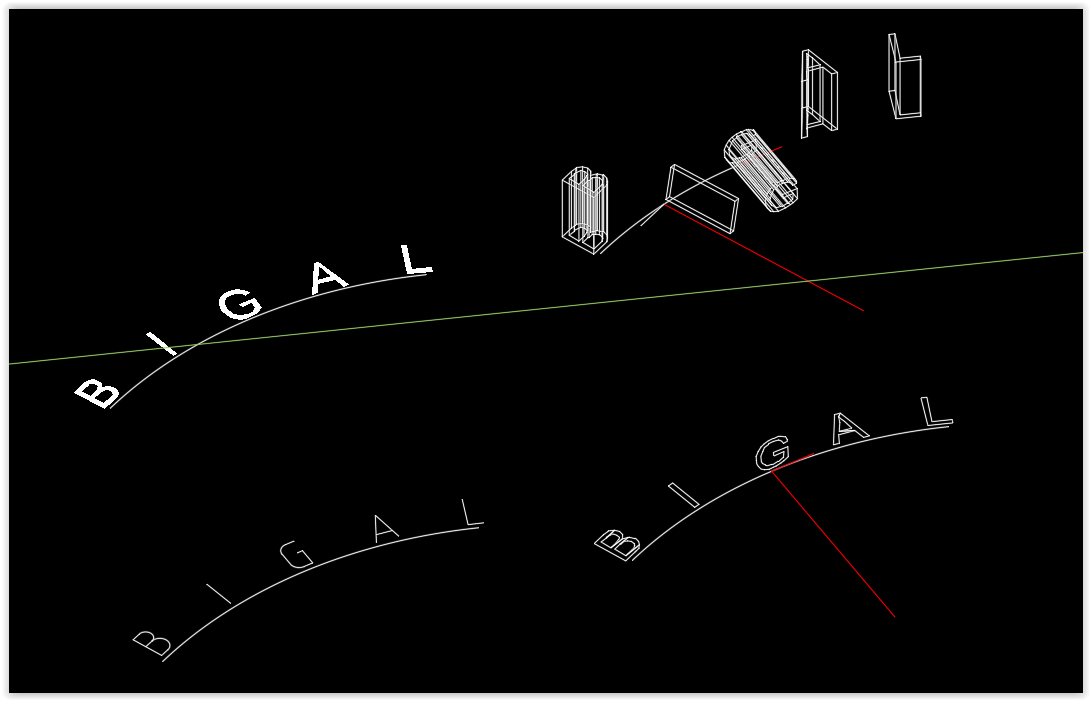

Had another go the steps
ARCTEXT enter text EXPLODE
Chose font
txtexp cleaned up and made plines
Extruded and subtracted for true 3d shape
Use a radial line the a 90 degree line at end
ROTATE3D pick 3dsolid and used 2 point option on the 90 line and angle 90
Repeated for I and G in image
