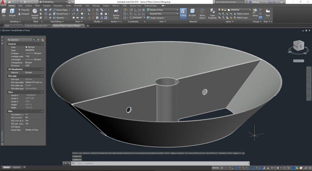

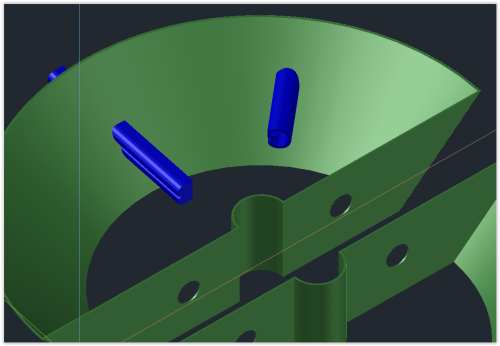

CMAGEE94 Posted September 13, 2018 Share Posted September 13, 2018 Hi, Just looking for some help in trying to create something. Attached is a file where I've done as much as i can. Not that educated on AutoCAD just mainly SolidWorks. Trying to just get it to look like a real thing instead of just a mesh shape as it is now. Need two holes on the vertical face aswel where two of these would screw together to make a whole circle. This will be fit onto a lighting column (lamp post) and will have the name of the local area on the angled face. Hard to explain what exactly i'm looking for but can give more info if needed. Hopefully looking at the CAD file you'll see what i mean. Any help would be appreciated !! Sense of Place Column Fitting.dwg Quote Link to comment Share on other sites More sharing options...
f700es Posted September 13, 2018 Share Posted September 13, 2018 I would make them out of solids and not meshes. You could then use the imprint command for the logo/name on the curved surfaces. Here's what I did in about 5 minutes. Sean Edit: You could also look at AutoDesk Fusion 360 under the free hobbyist license Column Fitting edit.dwg Quote Link to comment Share on other sites More sharing options...

CMAGEE94 Posted September 14, 2018 Author Share Posted September 14, 2018 Got this so far... Need a white panel adding around it and for black writing to be on the white panel. HELP. Sense of Place Column Fitting.dwg Quote Link to comment Share on other sites More sharing options...

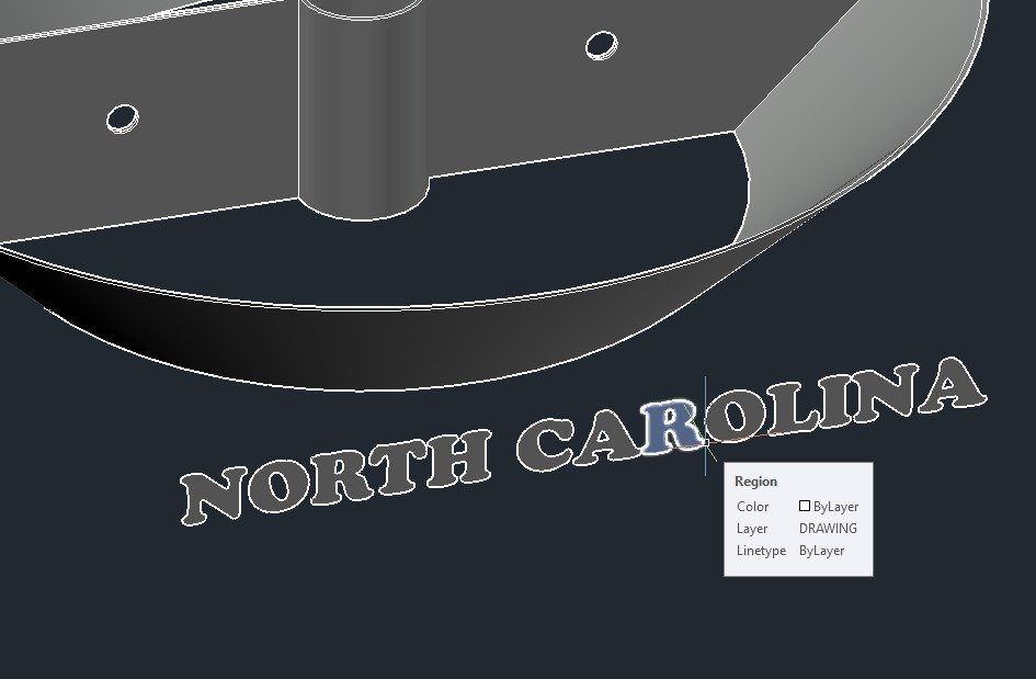

CMAGEE94 Posted September 14, 2018 Author Share Posted September 14, 2018 Cheers, just want to get a white banding around it now with some writing. Its the writing which is more important and the part im struggling with most. Probably east to do just cant get it or find any way to get text at an angle and to follow the curvature of the surface. Doesnt need to be perfect its just to give a visual representation of what im looking to get manufactured. Column Fitting edit.dwg Quote Link to comment Share on other sites More sharing options...

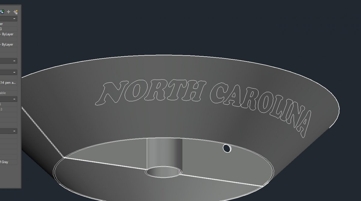

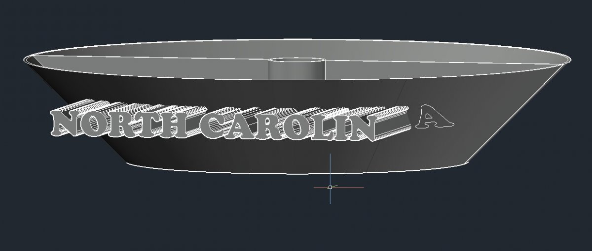

f700es Posted September 14, 2018 Share Posted September 14, 2018 OK... Create some text. Use txtexp to explode the text Use the region command to clean up all text align the text to where you want it extrude the text past the outer surface of the shape use the imprint command to imprint each letter to the surface of the shape it will ask to remove original object, say yes and there you go Quote Link to comment Share on other sites More sharing options...

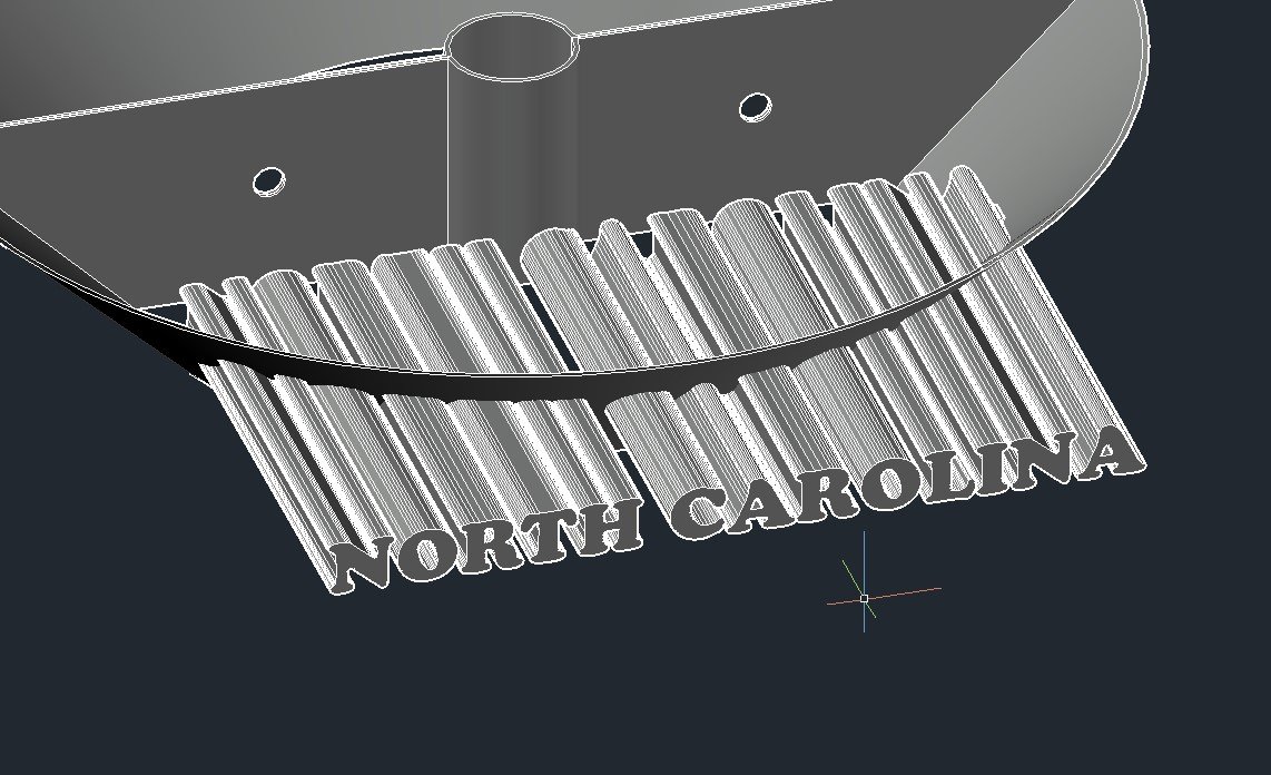

CMAGEE94 Posted September 14, 2018 Author Share Posted September 14, 2018 Great start... NOT. How are you inserting the text? Inserted some just using text command but when using txtexp it turns the text funny and cant see what it says. The later stages of the steps will be easy however getting this text right first is the problem. Be helpful if you could just type ST. PETERS SQUARE onto it or stop before the end at a point where the txt is capable of being changed Thanks. Quote Link to comment Share on other sites More sharing options...

f700es Posted September 14, 2018 Share Posted September 14, 2018 Sense of Place Column Fitting-text.dwg See if this will work Quote Link to comment Share on other sites More sharing options...

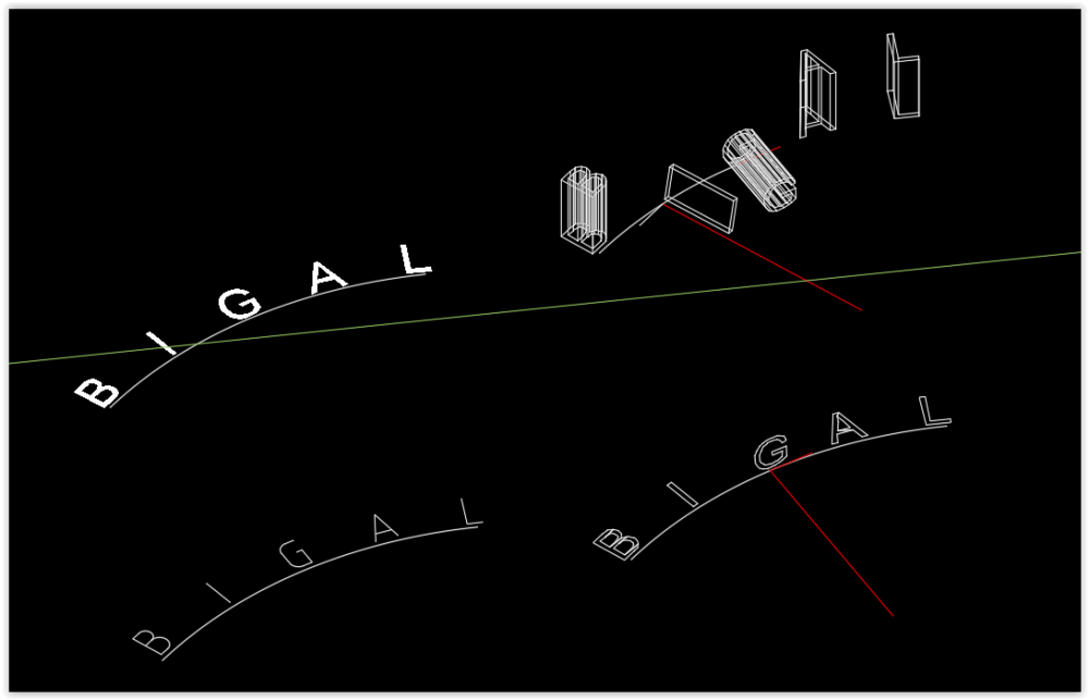

scj Posted September 16, 2018 Share Posted September 16, 2018 Suppose it is better to have the central projection (not the orthographic - have a look at the "E" at the end of the text) Regards Jochen www.ant-ares.de Sense of Place Column Fitting-text_scj.dwg Quote Link to comment Share on other sites More sharing options...
f700es Posted September 16, 2018 Share Posted September 16, 2018 True the best way would be for the letters to be on a curve as well before projecting them on the surface. Good call. Quote Link to comment Share on other sites More sharing options...
