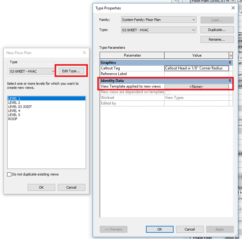

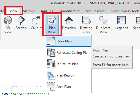

View > Plan Views (Image 1). This creates a completely new, raw and unfettered view with no overrides, so as long as you do not have any View Templates applied to the new View Type (Image 2).
Image 1: New View
Image 2: View Template Applied To New Types option
So, you do not "UNDO" the overrrides, but you simply make a new plan or view with no overrides??
Thanks for the assist, sir.
