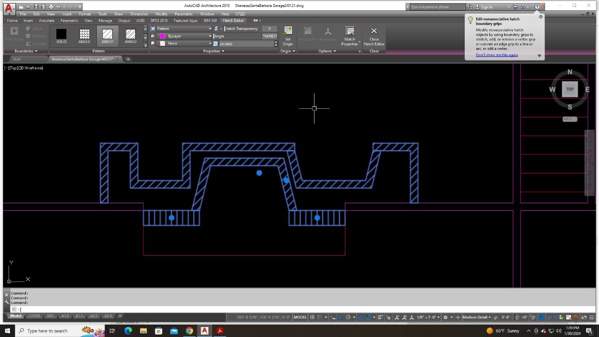

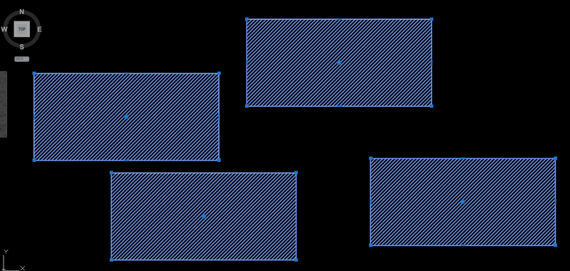

Cad64 Posted September 5, 2018 Posted September 5, 2018 Here's what I get. As you can see, the associative hatch has one grip in the center and the non-associative hatch has grips on all corners. Maybe there's a setting that controls grip display? Quote

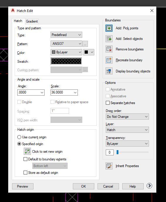

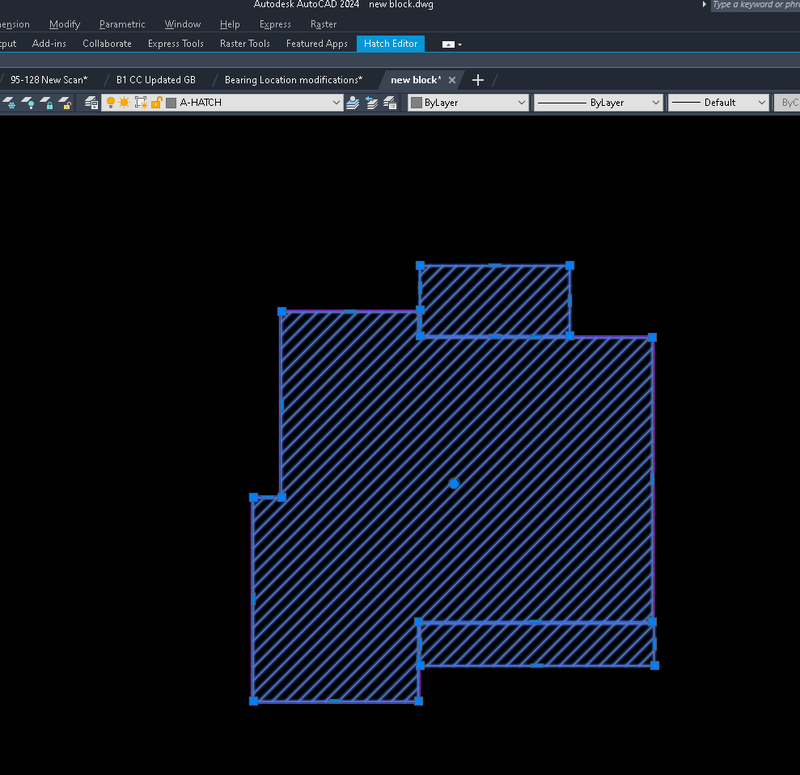

Macruairidh Posted January 21 Posted January 21 What should GRIPMULTIFUNCTIONAL VALUE BE? Mine is set to 3. I have never had this issue in other versions of AutoCAD. I attached my a screenshot of my Hatch Editor Quote

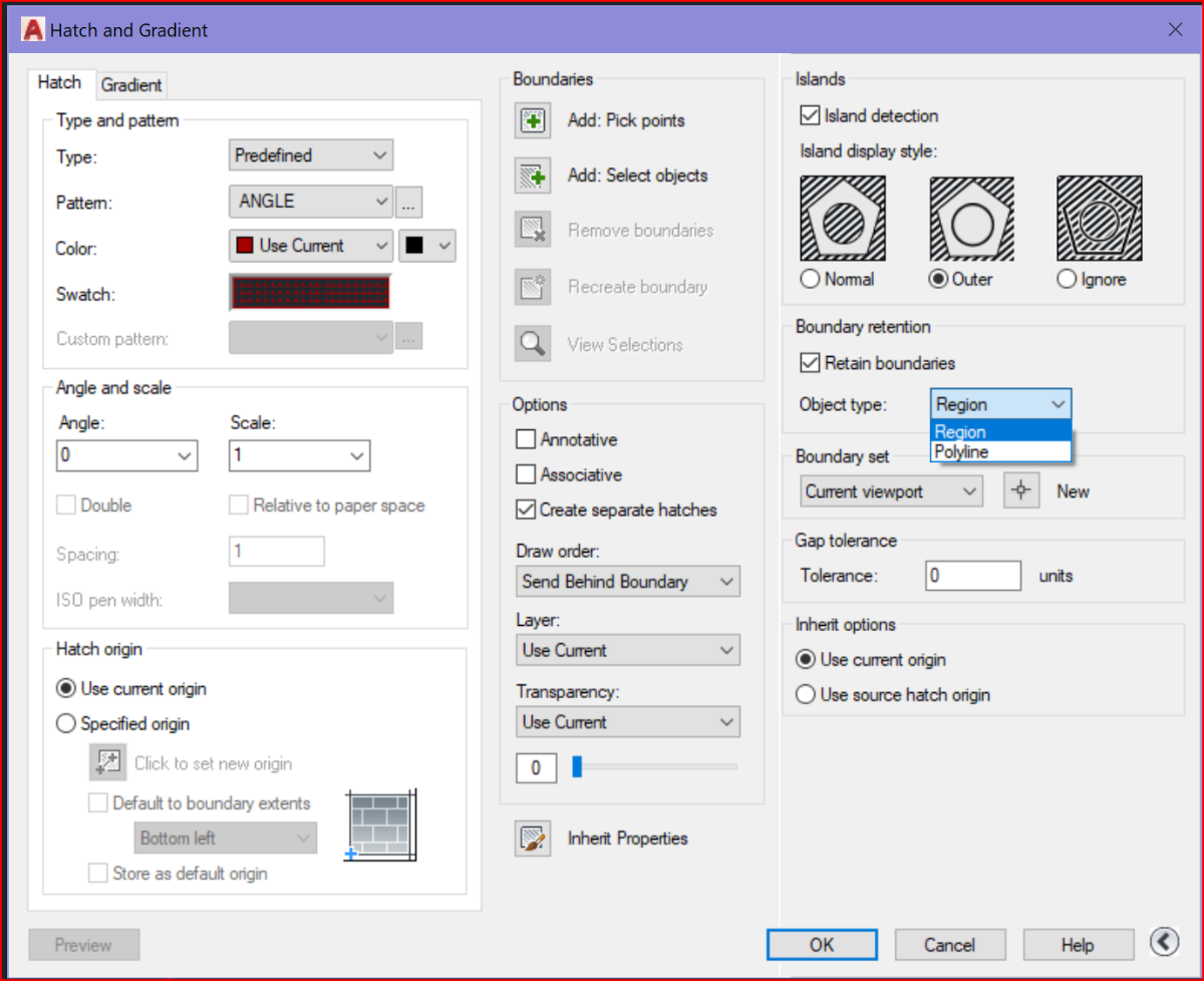

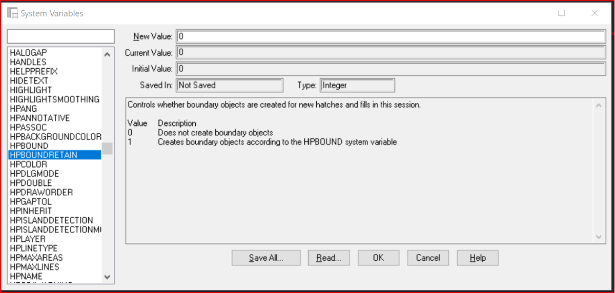

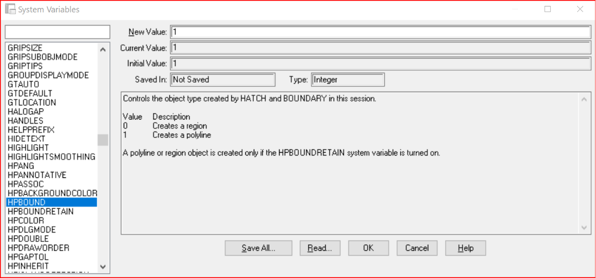

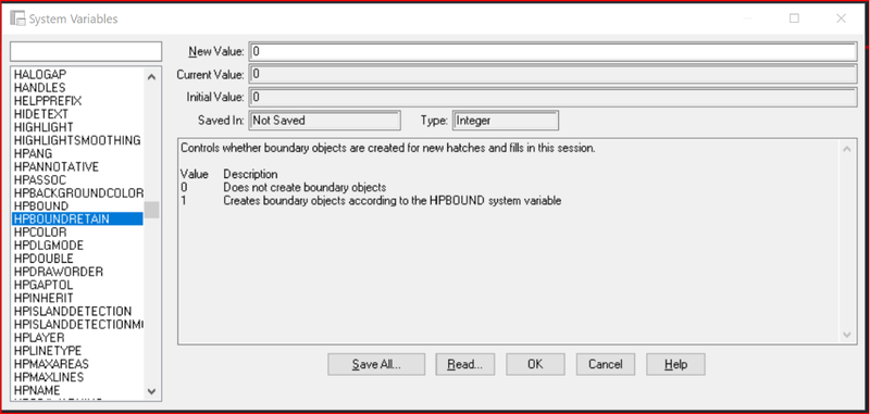

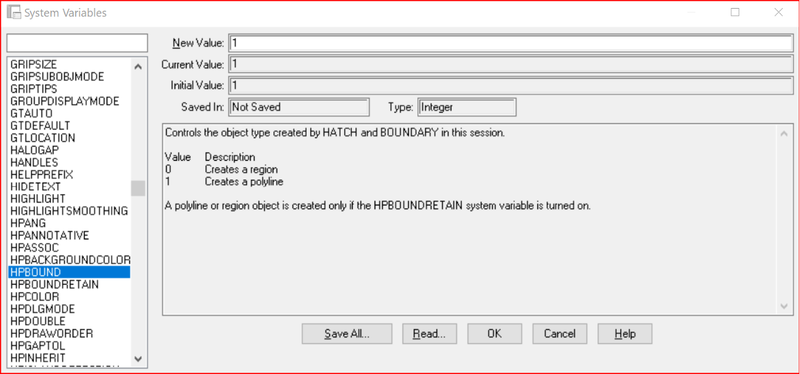

Dadgad Posted January 22 Posted January 22 (edited) Check your HPBOUND System Variable setting, as shown in the screenshot, taken from SYSVDLG (to accessthe belly of the beast). I believe you want it set to "1". You may need to check your HPBOUNDRETAIN variable setting too, and I believe you want it to be set to "1" also. In the screenshot, with the HATCH Settings dialog box fully opened, you can see the Island Detection Settings too, in case neither of the earlier suggestions has gotten you back on the tracks? Edited January 22 by Dadgad additional variable consideration again Quote
SLW210 Posted January 22 Posted January 22 16 hours ago, Macruairidh said: What should GRIPMULTIFUNCTIONAL VALUE BE? Mine is set to 3. I have never had this issue in other versions of AutoCAD. I attached my a screenshot of my Hatch Editor My Gripmultifuntion is 3 and I get grips on all my hatches, associated or not. You haven't posted a .dwg yet. Quote
SLW210 Posted January 22 Posted January 22 8 hours ago, Dadgad said: Check your HPBOUND System Variable setting, as shown in the screenshot, taken from SYSVDLG (to accessthe belly of the beast). I believe you want it set to "1". You may need to check your HPBOUNDRETAIN variable setting too, and I believe you want it to be set to "1" also. In the screenshot, with the HATCH Settings dialog box fully opened, you can see the Island Detection Settings too, in case neither of the earlier suggestions has gotten you back on the tracks? I get grips no matter those settings values. Quote
Macruairidh Posted January 30 Posted January 30 GRIPS=2; HPBOUND=1; HPBOUNDRETAIN=0; GRIPMULTIFUNCTIONAL=3......Still no Grips Quote
