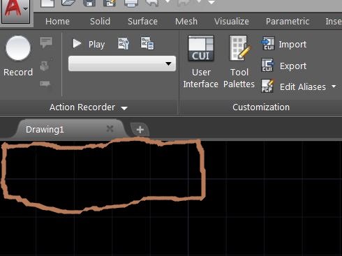

ntp327 Posted September 4, 2018 Share Posted September 4, 2018 there is something missing here, how I get it back.. autocad 2017 [+][Perspective] [Standard] [Default shading]... this is gone Quote Link to comment Share on other sites More sharing options...

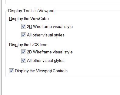

Cad64 Posted September 4, 2018 Share Posted September 4, 2018 Go to Options > 3D Modeling tab and make sure "Display the Viewport Controls" is checked. Quote Link to comment Share on other sites More sharing options...
ntp327 Posted September 4, 2018 Author Share Posted September 4, 2018 still missing... Quote Link to comment Share on other sites More sharing options...
Cad64 Posted September 4, 2018 Share Posted September 4, 2018 What happens if you wave your cursor around in that corner? Does it change from the crosshairs to a pick arrow? If so, go to "Options" > "Display" tab > Colors > 2D Model Space > Viewport Control and make sure the color is set to white or some other color that is different from your background. 1 Quote Link to comment Share on other sites More sharing options...
ntp327 Posted September 4, 2018 Author Share Posted September 4, 2018 thanks... resolve...change color and wala...magic... gracias... Quote Link to comment Share on other sites More sharing options...
