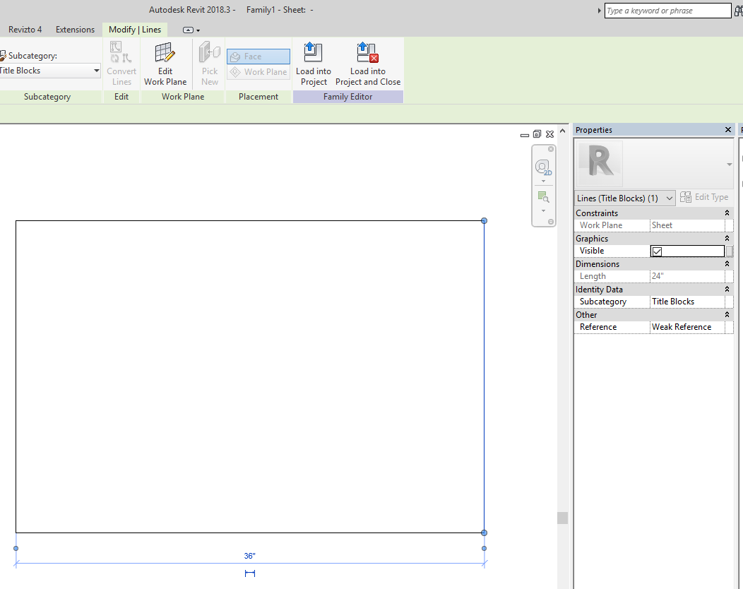

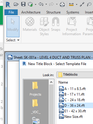

Without a Revit project file and Family to look at I can't tell how you're doing it and what's going wrong. I do know that there is a separate Titleblock Creation element to Revit (File > New > Titleblock). That will prompt you with this image:
Then you'll have the default standard sizes to choose from or use New Size for something custom. From there, you will notice a rectangular set of lines in which cannot be deleted: this is the "extents" of the sheet if you will. So anything inside of this "sheet extents" should  be your Titleblock linework, text, Logo, etc. The distances you make it off this outer border is the distance it'll print at so as long as your printer or PDF plot driver is set to 100% Scale and full bleed. Image here for reference:
