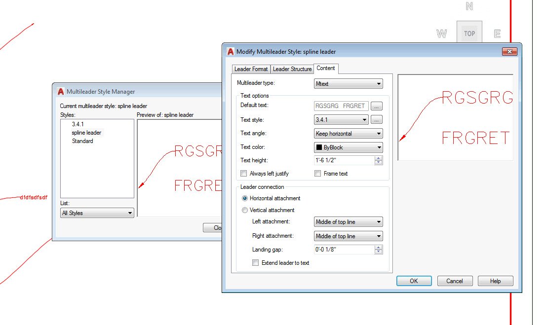

Sengna Posted August 23, 2018 Posted August 23, 2018 (edited) Hello, Does anyone know how can i set to default Not to have Multi leader text sitting on the line ? i want to be able to set it in the Multi leader setting window, i want to keep it the same each time. see issue on pic. thank you. Note Autocad 2017 Edited August 23, 2018 by Sengna Quote

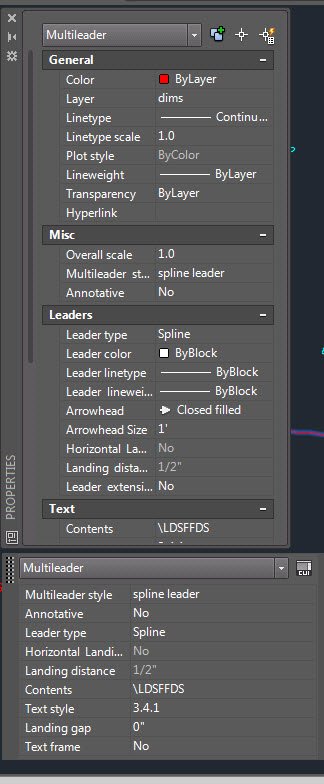

Sengna Posted August 24, 2018 Author Posted August 24, 2018 i am going through the drop down list on the editor now, the one i am using is spline leader, Annotative: no,..........still can not find the solution yet. Quote

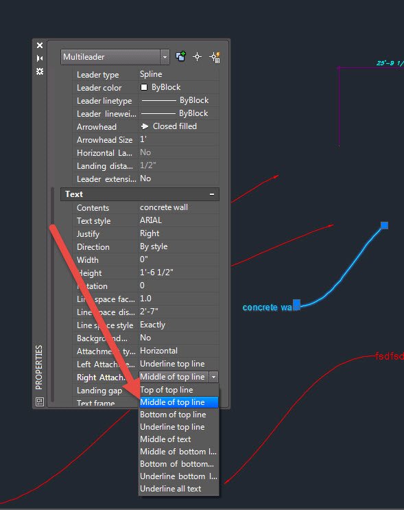

dlanorh Posted August 24, 2018 Posted August 24, 2018 (edited) On 8/24/2018 at 3:10 PM, Sengna said: i am going through the drop down list on the editor now, the one i am using is spline leader, Annotative: no,..........still can not find the solution yet. Expand Scroll down the list and find the "leader connection" section (use darkened scroll bar to left of sections). It's somewhere below "Text" on the "Properties" palette. There should be two drop down boxes for left attachment and right attachment. One or both of these will be set to underline top line or something similar. Change these options to another from the list. Edited August 24, 2018 by dlanorh Quote
Sengna Posted August 24, 2018 Author Posted August 24, 2018 Thank you dlanorh, Got it, i tested each and the one that will remove underline is using "middle of top line" thanks so much everyone. Quote
Dana W Posted August 24, 2018 Posted August 24, 2018 That is your object Properties dialog, not the mleader editor. The Properties dialog only works for the current selection set. The mleader style editor will change every leader in that style all at once. 1 Quote

Sengna Posted August 28, 2018 Author Posted August 28, 2018 i went in "MODIFY MULITILEADER STYLE" under content tap- Left and Right Attachment: "Middle of top line" these are what i want to set to, now it is set as default so i don't have to do each time. Off the topic: if i want to export all my setting ex: text, leaders, layers as template so that i can use the same format all the time, how can i do that? i appreciate any technique that you guy recommended. Thanks Quote
Dana W Posted August 28, 2018 Posted August 28, 2018 On 8/28/2018 at 7:04 PM, Sengna said: i went in "MODIFY MULITILEADER STYLE" under content tap- Left and Right Attachment: "Middle of top line" these are what i want to set to, now it is set as default so i don't have to do each time. Off the topic: if i want to export all my setting ex: text, leaders, layers as template so that i can use the same format all the time, how can i do that? i appreciate any technique that you guy recommended. Thanks Expand This sort of change lives in the drawing individually. If you want to make it permanent for all new drawings, set up a template drawing with this mleader style in it and start all your new drawings from the template. You can also simply copy one of the multi-leaders of this style to another drawing using the clipboard and it will live in that drawing too. BUT the new leader style MUST have a unique name first. If it is copied to another drawing and there is already a style named the same in there already, the existing style will override your new one and it will remain unchanged in the drawing you copied to, just like a block definition. 1 Quote
