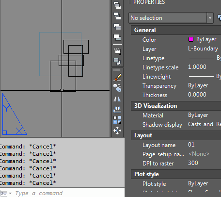

  On 8/27/2018 at 8:32 PM, loudy000 said:
no worries :) see attached if you want to have a look at it. Cheers!
Enclosed polylines.LSPFetching info...
Expand
Let's see if we can pimp that one :)
  On 8/27/2018 at 3:00 PM, Stefan BMR said:
You can try the Enclosed Polylines.lsp from here.
Expand
Hi Stefan! Very clever piece of coding there! I'm not sure if the version loody attached is your latest version, but I noticed that the 1rst line makes the 2nd line bomb. (*acDoc* is define on the 1rst line while the 2nd uses an undefined variable acDoc).
Now, lets see what I can do with it with some matrix functions kindly made available by Vladimir Nesterovsky, Doug Wilson and Gile... (Merci Gilles. Tu es un mentor et une source d'inspiration même à une distance de probablement plusieurs fuseaux horaires!)
Not bad, heh? :)
Not bad, heh? :)
Soooo! If 14$ is too expensive, tell us how much you think would be a fair price? (ie not too expensive....). I'm wondering how much our time is worth to someone who will get the credit for an increased productivity. At least a "like" I hope.
Enjoy ;)

        (princ "\nValid region(s) not found")

There you go 😃 it’s 3:26am here and can’t help but open my pc to test your code 😂. This is pretty decent mate! Ah forget about the price I’m really just a poor guy 😐
Thanks again 😘

hey @Jef!. it’s been a while, hope all is good.. thank you for this great code! it works great however im facing problem and if i have overlapping lines. is there a way to you ignore overlapping and continue to produce closed polyline? thank  you very much .
Edited by loudy000
BEST IS : 1. MAKE HATCH BY PICK INTERNAL POINT.
                  2. SELECT ALL HATCH AND RIGHT CLICK GENERATE BOUNDARY. AND DELETE ALL HATCH.
