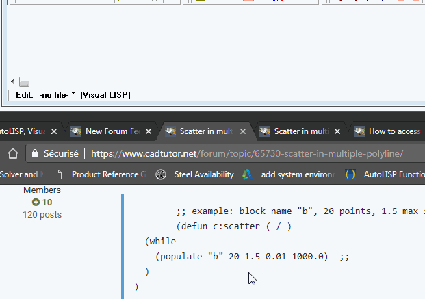

Jef! Posted August 24, 2018 Posted August 24, 2018 Added Chars (question marks) after COPYING from CODE (I'm joining an animated gif to show the behavior, hoping it shows) That happened to me maybe 3-4 times so far. Trying to figure out why this code bombed on my side, I found out that the var "msp" wasn't defined (but the var "msp?" was). I was about to post about that and noticed that the the var in the code section was actually "msp", and not "msp?". (Having tried numerous time in the past to use "wisiwig" kind of things, I found out that too often we get our text messed due to hidden mismatched tags, so back then I just learned how tags worked and controled them manually, turning off for good wisiwig.) I thought that maybe some kind of html tags were responsible for the added question marks, I pasted in notepad (that I always use to remove all formatting from copied text when I need to remove formatting) and to my surprise it modified the police of the txt file after pasting in it. In vlide, it instead adds randomly "?" The weirdest part is that when I reload the page either "?" don't insert themselves in copied text, or get inserted randomly at (other) random positions as example below. (I just noticed on the gif that it added one inside the c:scatter function as well.) So I went back, reloaded the page, copied and pasted again and look. None in scatter and in the "msp" var name, and none at the end of that line but one has been added before the scatter command. Am I the only one having that issue? 1 Quote
CADTutor Posted August 24, 2018 Author Posted August 24, 2018 So, if I can summarise; if you paste the code copied from a code block into Notepad, the extra characters are not there but if you paste into the Visual Lisp editor, they are there? What happens if you copy the pasted code from Notepad and paste it into the Visual Lisp editor? Quote
Jef! Posted August 24, 2018 Posted August 24, 2018 On 8/24/2018 at 5:21 PM, CADTutor said: So, if I can summarise; if you paste the code copied from a code block into Notepad, the extra characters are not there but if you paste into the Visual Lisp editor, they are there? What happens if you copy the pasted code from Notepad and paste it into the Visual Lisp editor? Your summarisation.. summation.. you summarized (almost) perfectly. The chars do not "appear" in notepad, but are still there (they are responsible for the police change I think). I just tested to be sure, and if I copy back from notepad to vlide, the "?" follow and tag along and get pasted as well at the same position, regardless is I go directly in vlide or from post to notepad to vlide. I would have expected otherwise if notepad would have removed the formatting.... I'm using chrome, if anyone is wondering. Quote
CADTutor Posted August 24, 2018 Author Posted August 24, 2018 Wow! Notepad is supposed to be plain text - if you can't see it, it ain't there. How is that even possible? Can you give us a link to the post you were copying from so I can see if it can be replicated? Be good to get some feedback from others - anyone else seeing the same thing? Quote
steven-g Posted August 24, 2018 Posted August 24, 2018 It imports just fine in Bricscad Blade, and checking it in a hex with Notepad++ there are no weird characters hiding anywhere, could it be a system language setting? Quote
Jef! Posted August 24, 2018 Posted August 24, 2018 (edited) On 8/24/2018 at 5:51 PM, CADTutor said: Wow! Notepad is supposed to be plain text - if you can't see it, it ain't there. How is that even possible? Can you give us a link to the post you were copying from so I can see if it can be replicated? Be good to get some feedback from others - anyone else seeing the same thing? I provided the link in the 1rst line of my preceding message. Here's the link again. The source doesn't matter tho. I cannot explain why it randomly occurred in the first place, but I found a way to replicate it 100% of the time. I'm baffled. 1rst time I copy, all fine, 2nd time it adds 1 "?", 3rd time it adds a 2nd "??", and so on. One thing that crossed my mind, which is is might be special chars. I pasted in notepad, (the police changes), and tried to saveas. 1rst attempt, notepad froze solid, i had to terminate the process. 2nd try, saveas worked, and as expected got the popup telling me that this file contains unicode formatted chars, and they would be lost if I save in ansi format. If I paste here I see that it is the left blue border of the code section from which I copied. (populate "b" 20 1.5 0.01 1000.0) x-files type kind of stuff... edit: if I paste in word, I don't have the left border, but the background of the line in light blue, same as in the code /code blocks... Edited August 24, 2018 by Jef! Quote

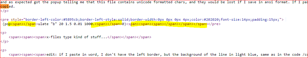

Jef! Posted August 24, 2018 Posted August 24, 2018 (edited) they are empty span tags and it appears as "?" when they are pasted (I just cannot figure out why 1 pair seems added for every subsequent copy paste, or why they can be added at random spots in the copied string). Here's what is behind my preceding post if I look at the source code of the page So that is what is behind the "(pop?ulate "b" 20 1.5 0.01 1000.?0)????" (last paste that i made in the video)... edit: Apparently it is a it's a side effect of copying HTML in browsers, specifically Chrome. -> Source link! <- Edited August 24, 2018 by Jef! Quote

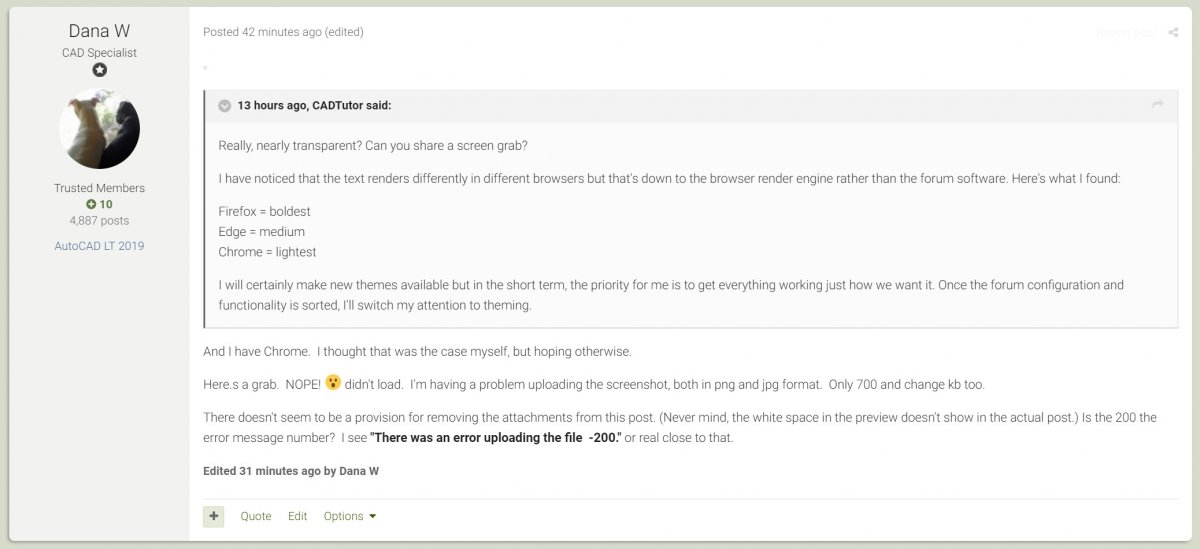

Dana W Posted August 24, 2018 Posted August 24, 2018 (edited) On 8/24/2018 at 8:40 AM, CADTutor said: Really, nearly transparent? Can you share a screen grab? I have noticed that the text renders differently in different browsers but that's down to the browser render engine rather than the forum software. Here's what I found: Firefox = boldest Edge = medium Chrome = lightest I will certainly make new themes available but in the short term, the priority for me is to get everything working just how we want it. Once the forum configuration and functionality is sorted, I'll switch my attention to theming. Expand And I have Chrome. I thought that was the case myself, but hoping otherwise. Here.s a grab. NOPE! didn't load. I'm having a problem uploading the screenshot, both in png and jpg format. Only 700 and change kb too. There doesn't seem to be a provision for removing the attachments from this post. (Never mind, the white space in the preview doesn't show in the actual post.) Is the 200 the error message number? I see "There was an error uploading the file -200." or real close to that. Edited August 24, 2018 by Dana W Quote

Dana W Posted August 24, 2018 Posted August 24, 2018 Trying again to upload a grab of my faint font screen. My upload issue was OE. I still had the file open in Paint. Quote
CADTutor Posted August 25, 2018 Author Posted August 25, 2018 On 8/24/2018 at 8:00 PM, Jef! said: Apparently it is a it's a side effect of copying HTML in browsers, specifically Chrome. OK, I can see the logic in that. When the code snippet is copied, the style information is copied with it. This can be demonstrated by pasting into Word. The background colour and font are also pasted (unless "Keep Text Only" is selected). However, I can't replicate your problem when pasting into VLIDE. I've tried with Firefox and Chrome. In both cases I just get plain text. So I'm now wondering if this has been a change in the way VLIDE pastes copied text or whether browsers have changed the way they encode the styling. I'm using the latest Firefox and Chrome and using AutoCAD 2017. I see you're using AutoCAD 2015, so I'm wondering if that's where the change happened. I think we need some feedback from people using other versions of AutoCAD before we get a definitive answer. Quote
CADTutor Posted August 25, 2018 Author Posted August 25, 2018 On 8/24/2018 at 10:14 PM, Dana W said: Trying again to upload a grab of my faint font screen. Ooh, that does look faint. That's not what I'm seeing, even Chrome isn't that bad on my monitor. I'm really not sure what's causing that - the whole render looks poor, not just the text. Do you see the same thing on other websites or just this one? Quote
Dana W Posted August 25, 2018 Posted August 25, 2018 (edited) On 8/25/2018 at 8:24 AM, CADTutor said: Ooh, that does look faint. That's not what I'm seeing, even Chrome isn't that bad on my monitor. I'm really not sure what's causing that - the whole render looks poor, not just the text. Do you see the same thing on other websites or just this one? Truthfully the clarity of my image did degrade considerably in the processing from screen print, pasted to to MS Paint saved as *.jpg, to upload. My screen is not that fuzzy. In fact it is crystal clear, just faint. However, the contrast level is exactly the same in my upload as it appears on my screen. I do have a similar but better default look in MS Office products, Outlook, Word, and Excel for example. The "soft" appearance in the MS programs appeared a few years ago with the Advent of the ribbon there, and I think it was intentional. There are ways to modify the "default" look in those programs which have been taken advantage of. I have not found any other similar appearing websites so far. I am including my own hardware, tied for first place in the Usual Suspects List. It could simply be something in my 27" actual glass touch screen that can't handle the medium gray font on the pale gray/green background. Edited August 25, 2018 by Dana W Quote

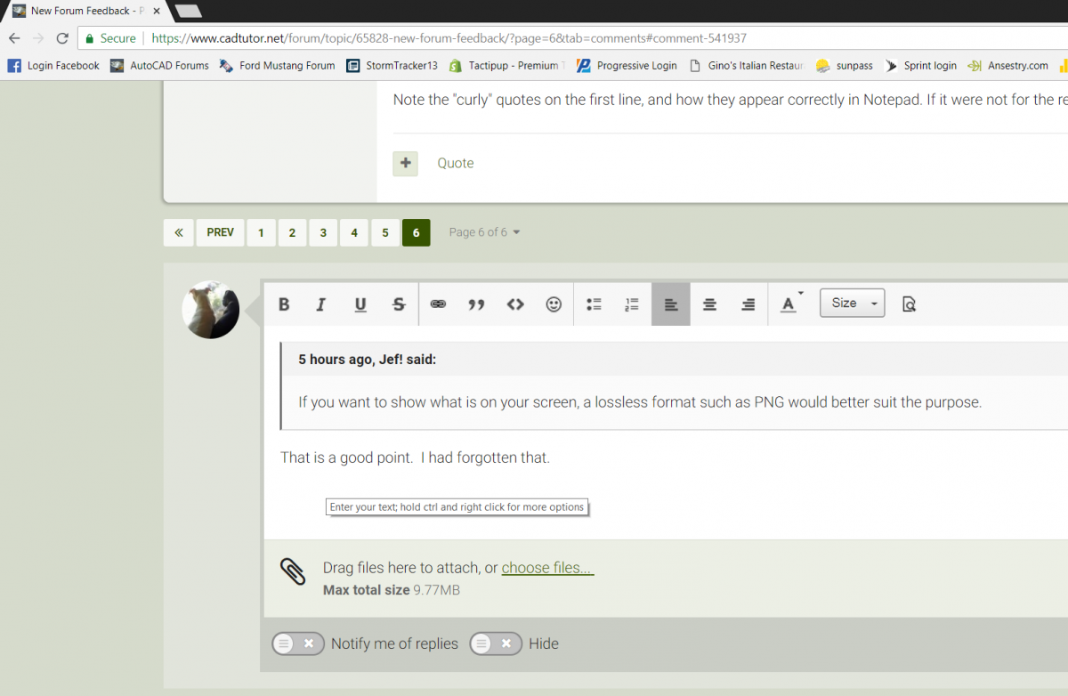

Dana W Posted August 27, 2018 Posted August 27, 2018 (edited) On 8/27/2018 at 3:34 PM, Jef! said: If you want to show what is on your screen, a lossless format such as PNG would better suit the purpose. Good point. I had forgotten the difference. here's a png. EDIT: sheesh, this one's text is more contrasty than my screen by about 10%, but the png is also more blurry than my screen. Edited August 27, 2018 by Dana W Quote
tzframpton Posted August 28, 2018 Posted August 28, 2018 On 8/27/2018 at 9:11 PM, Dana W said: Good point. I had forgotten the difference. here's a png. EDIT: sheesh, this one's text is more contrasty than my screen by about 10%, but the png is also more blurry than my screen. Save as Tif, it's lossless. It'll be identical. Quote
