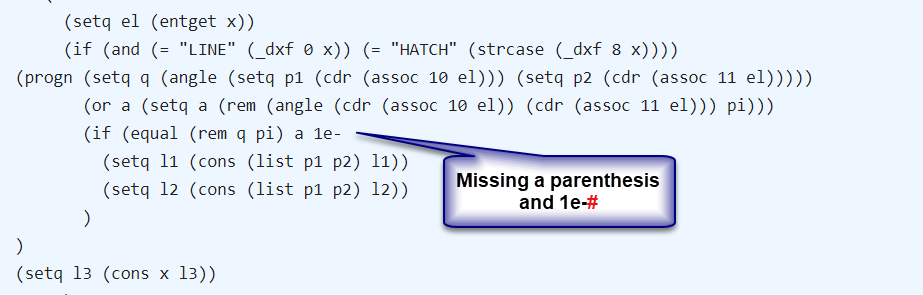

ronjonp Posted August 21, 2018 Share Posted August 21, 2018 I'm pretty sure this code was intact before the migration... Quote Link to comment Share on other sites More sharing options...
CADTutor Posted August 21, 2018 Author Share Posted August 21, 2018 It's not impossible and there are various things that may have caused this. The data in the old forum was subject to a number of changes during the migration. First there was a character set translation from latin1 to UTF-8. This was unavoidable and brings the forum into line with contemporary web content. In the vast majority of cases, this will have made no difference to the characters displayed but there are always edge cases. Second, the translation of code that includes special characters such as the octothorpe (hash) character can cause problems as these have special meanings in HTML. If the characters were incorrectly encoded in the first place, they may have been stripped out. I do appreciate that those sort of translation problems can have serious consequences for code scripts but it's not something that could easily have been foreseen. You can amend that code block by clicking the Code button while editing the post. 1 Quote Link to comment Share on other sites More sharing options...
ronjonp Posted August 21, 2018 Share Posted August 21, 2018 No worries .. just bringing it to your attention. I have far too many code posts to fix translation errors Quote Link to comment Share on other sites More sharing options...
CADTutor Posted August 21, 2018 Author Share Posted August 21, 2018 8 minutes ago, ronjonp said: No worries .. just bringing it to your attention. I have far too many code posts to fix translation errors OK, I think I've worked out what's going on. A quick look at the affected code indicates that where the hash character in used, the rest of that line has been omitted. The likely cause for this is in the PHP parsing of the code. The hash character (#) is a comment character in PHP i.e. it and everything after it is ignored. It looks as though that's what happened in this case and it's obviously a bug in the translation software. I'll report this back to the developers. It should be fine to use that character going forward, it only affects translated code blocks. Quote Link to comment Share on other sites More sharing options...
CADTutor Posted August 21, 2018 Author Share Posted August 21, 2018 Confirmed. This was a bug in the code translator. It's now been fixed but sadly too late for us 2 Quote Link to comment Share on other sites More sharing options...
ronjonp Posted August 21, 2018 Share Posted August 21, 2018 The next flood of posts will be: "I copied your codes and get 'malformed list on input'." 1 Quote Link to comment Share on other sites More sharing options...
CADTutor Posted August 21, 2018 Author Share Posted August 21, 2018 To be clear, this bug only affects code with specific characters or character combinations. Fortunately, those characters/combinations are not common in AutoLISP so I don't expect this to have affected a large number of code blocks. However, let me know if you think otherwise. Quote Link to comment Share on other sites More sharing options...
CADTutor Posted August 21, 2018 Author Share Posted August 21, 2018 1 hour ago, ronjonp said: The next flood of posts will be: "I copied your codes and get 'malformed list on input'." A quick survey of code posted prior to last weekend seems to reveal that this will be rare. I couldn't find any other instances apart from the one you highlighted. However, I'd appreciate it someone with a more acute eye for code could also take a look and report back. Quote Link to comment Share on other sites More sharing options...

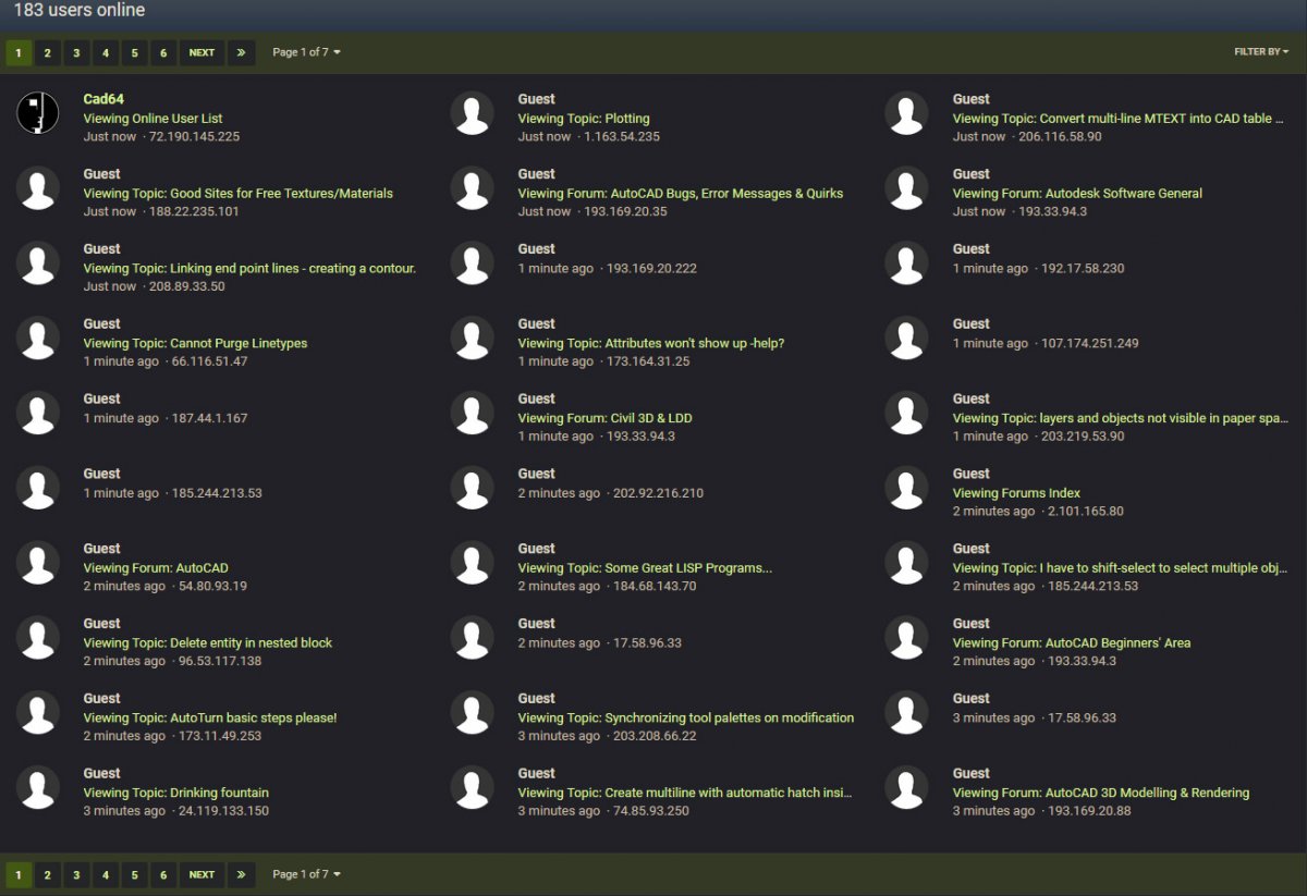

Cad64 Posted August 21, 2018 Share Posted August 21, 2018 I just checked the online user list and apparently it's just me and 182 ghosts, I mean guests. Lol By the way, I'm really liking this new drag and drop image upload functionality. So much easier and faster than the old way. 1 Quote Link to comment Share on other sites More sharing options...
CADTutor Posted August 21, 2018 Author Share Posted August 21, 2018 Ha! But if you use the "filter by" option at top right and select "Logged In", you can see who's really here 1 Quote Link to comment Share on other sites More sharing options...
Cad64 Posted August 21, 2018 Share Posted August 21, 2018 That's better. Now I can see who's actually logged in, and not just the guests. Quote Link to comment Share on other sites More sharing options...

David Bethel Posted August 22, 2018 Share Posted August 22, 2018 Quote and not just the guests. My bet is the quests are search engine spiderbots. When they crawl a site, they usually open a bunch of files in quick succession so the hit count can get quite large fairly quickly. I don't know how long these type of reports keep a visit as active after the initial hit. Quote Link to comment Share on other sites More sharing options...
CADTutor Posted August 22, 2018 Author Share Posted August 22, 2018 7 minutes ago, David Bethel said: My bet is the quests are search engine spiderbots. Many of them will be and one of the tweaks I just made to the forum is to serve only chached pages to guests, so that won't affect spiders but will reserve more server oompf for logged in users. Quote Link to comment Share on other sites More sharing options...
