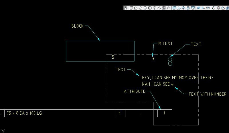

hopefull this will help a little.
i want it to have an answer of 17,.....3 + 1 + 8 + 5.
the phantom line, is my selection menu.

So the Text with number (dodgy text as it is...) can be ignored I take it.
You mean the one that says, "i can see 4"
yes, that is to be ignored. leaving the 3 , 1 , 8 , 5, to only be read.
