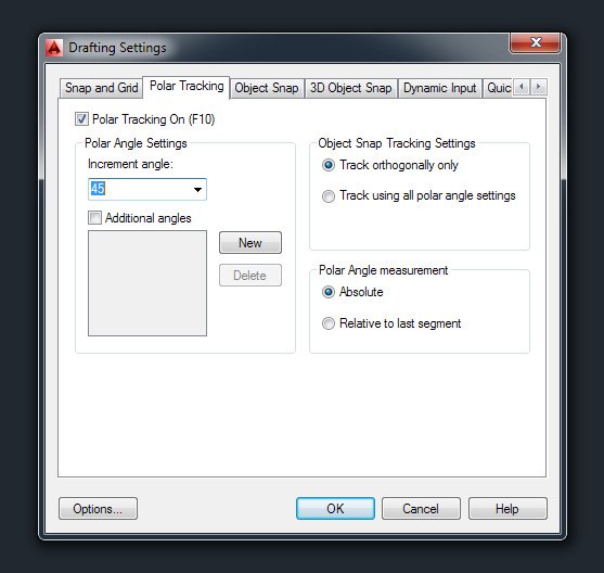

aban Posted August 16, 2018 Posted August 16, 2018 Hello, is there any way to get ortho to also include 45 degrees? I know polar tracking has the different angles, but I would need ortho to do that. If not, is there a way to make a lisp file to assign "DD" to turn that lisp file on? Please help with this because I really need this to work. Thank you! Quote

CyberAngel Posted August 16, 2018 Posted August 16, 2018 I don't see why you'd need Ortho to use polar tracking. Set your increment to 45 degrees and you should be okay. Quote

tombu Posted August 17, 2018 Posted August 17, 2018 Sounds good, so that means that there is no typical autocad command to get that 45 degrees. Is there a way to make a lisp file to have ortho, but include the 45 degrees? Or some other way to customize it? Here's a simple toggle to change the snap angle between horizontal and 45°: (defun c:toggle45 () (if(= (+ (getvar "snapang")(getvar "viewtwist")) (* 2 PI)) (setvar "snapang" (-(/ PI 4) (getvar "viewtwist"))) (setvar "snapang" (- (getvar "viewtwist"))) ) (princ) ) Quote

Cad64 Posted August 21, 2018 Posted August 21, 2018 5 hours ago, aban said: I just want the three angles to work, 0, 45, and 90. I don't want any other angle to work at the time of the function. Like for example, if I do polar tracking I know that I could set 45 as an angle and it will snap to that, but it will also give me every single angle between 0 and 45 and between 45 and 90. I only want the three angles to work, 0, 45, and 90 exclusively. If you set your Polar Tracking increment angle to 45, all you will get is 45 increment angles. You won't get every other angle in between. 1 Quote

Cad64 Posted August 22, 2018 Posted August 22, 2018 I guess I don't understand what you're trying to do? Polar Tracking will allow you to snap to 45 degree angles, but if you only want 0, 45 and 90, you will need to find someone who can write some code for this. There is no way in Autocad to restrict the angle snap to those angles only. You should post your request in the Autolisp section: https://www.cadtutor.net/forum/forum/15-autolisp-visual-lisp-amp-dcl/ Quote
