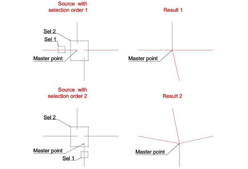

Jozef13 Posted August 15, 2018 Share Posted August 15, 2018 Dear all, I am looking for a lisp routine that join endpoints of multiple polylines to common point. I do not need to join them into one polyline, just touch all in one point. Based on selection I want to get "master point" of first polyline in selection and then connect all the rest of polylines to that point as shown in attached picture. Quote Link to comment Share on other sites More sharing options...
ronjonp Posted August 15, 2018 Share Posted August 15, 2018 Here you go... (defun c:foo (/ cp p s x) ;; RJP » 2018-08-15 ;; Puts plines and lines closest vertice to a common picked point (cond ((and (setq p (getpoint "\nPick common point: ")) (setq s (ssget "_:L" '((0 . "LINE,LWPOLYLINE")))) ) (foreach e (vl-remove-if 'listp (mapcar 'cadr (ssnamex s))) (setq cp (car (vl-sort (list (vlax-curve-getstartpoint e) (vlax-curve-getendpoint e)) '(lambda (r j) (< (distance r p) (distance j p))) ) ) ) (entmod (mapcar '(lambda (x) (cond ((equal (list (car cp) (cadr cp)) (cdr x) 1e- (cons (car x) p)) (x) ) ) (entget e '("*")) ) ) ) ) ) (princ) ) Quote Link to comment Share on other sites More sharing options...
Jozef13 Posted August 15, 2018 Author Share Posted August 15, 2018 Here you go... (defun c:foo (/ cp p s x) ;; RJP » 2018-08-15 ;; Puts plines and lines closest vertice to a common picked point (cond ((and (setq p (getpoint "\nPick common point: ")) (setq s (ssget "_:L" '((0 . "LINE,LWPOLYLINE")))) ) (foreach e (vl-remove-if 'listp (mapcar 'cadr (ssnamex s))) (setq cp (car (vl-sort (list (vlax-curve-getstartpoint e) (vlax-curve-getendpoint e)) '(lambda (r j) (< (distance r p) (distance j p))) ) ) ) (entmod (mapcar '(lambda (x) (cond ((equal (list (car cp) (cadr cp)) (cdr x) 1e- (cons (car x) p)) (x) ) ) (entget e '("*")) ) ) ) ) ) (princ) ) Perfect Thank you. I was struggling with polylines extended data but without success. Could you modify it to be possible to apply it also at POLYLINES ? Do not loose the time if it is more tricky. Quote Link to comment Share on other sites More sharing options...
