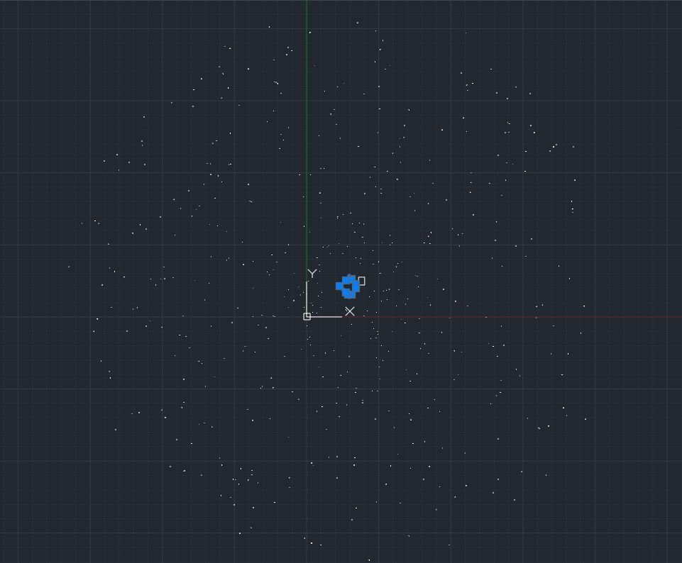

AndreasB Posted May 5, 2024 Posted May 5, 2024 Hi there! I'm trying to use this, but im having some problems unfortunately. Note that im very new at this Lisp, sorry. But whenever i'm trying to use it, it's not really doing anything inside the closed polyline? On the other hand it's actually putting everything outside in this kinda 'round' shape and wiiiidely spread. Do you have any idea, what's going on? Quote
