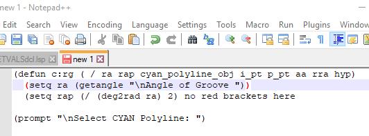

You have a parenthesis mismatch (1 closing parenthesis missing) on the line
(setq rap (/ (deg2rad ra) 2)
This kind of thing is easy to find if you use the visual lisp editor... (type vlide to start it)
You can use Vlide to debug or as others have said if using notepad++ it will show you enclosed brackets or an oldy prior to notepad and VLIDE is chkbrk lisp that I wrote like 30 years ago a missing bracket is one of the most common mistakes the second for me is a missing "
Using notepad++ just click on the start of the line the end brackets will go red.
I tend to write and test as I go so you can copy 1 line at a time to the command line or more and make sure it works, whiles and repeats get a bit trickier. Dont paste ; remarks.

  On 8/15/2018 at 2:57 PM, jonhite said:
  On 8/20/2018 at 6:35 PM, jonhite said:
I'll start using Notepad++. At least I know what not having matching parenthesis does.
hi, Notepad++ has nice formatting environment but for LISP efficiency & debugging i still prefer powerful VLIDE
FWIW, in VLIDE - matching parenthesis
Ctrl+M
Expand

I don't know if that is what is killing the LISP but once I make my selections, it just ends. No lines get drawn. I figure that is the next point to get to is to get the lines drawn on there.
Right now I have:
(while (setq ss (car (entsel "\nSelect CYAN Polyline: ")))
(setq cyan_polyline_obj (vlax-ename->vla-object ss))
(setq i_pt (getpoint "\nSelect Insertion Point on Blue Line "))
Do I remove (while (setq ss (car (entsel "\nSelect CYAN Polyline: "))) ? and replace it with (while (setq i_pt (getpoint "\nSelect Insertion Point on Blue Line ")) ?
What about (setq i_pt (getpoint "\nSelect Insertion Point on Blue Line ")) ? Do I remove that?
Is there a way that I can get feedback from the LISP to know how far the code gets? Can I have it write in the command line when it has the Angle Distance, Hyp Length, Calculates pt1 & pt2?
Ok... Here's a list of exactly what is wrong with the code.
-Getangle returns a value in radians. Because of that...
-neither the deg2rad function nor further processing is required and should be removed
-Like previously stated, the first prompt/setq of cyan_poly is useless as it is overwritten immediately. You just need the part in the while
-The angle is the angle of the notch (lets take 90 degrees as an example), which means that you need to divide it in 2 right angle triangles (with the adjacent from p_pt to i_pt) to calculate hyp as an hypotenuse. What it means is that you need to divide the angle by 2.
-In the polar functions you have the first argument (point) missing.
-Again in the polar function you swapped the 2 last arguments, hyp being the length. Polar is as follow (polar point angle distance)
-Same as hyp, in the polar the angle needed is half of the angle of the notch.
-You have 1 too many argument in the break command, the "_F" that I suspected yesterday. By running it manually I get a "Invalid point.", so fence is not available (nor required)
-(EDIT) I just noticed that since we use the line command, we have to turn off the osmode. If we don't the lines will snap everywhere.
-(EDIT) Since we change a VAR, a error handler is required to restore the osmode to its previous state if the user hits escape (and he might because of the while)
-(EDIT) If you want to exit quietly you need to add (princ) at the end.
Basically this is all you need to know to make the code work, and you should try to fix it on your own... don't spoil the fun! Don't look!
