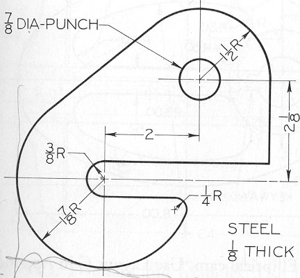

dniemeye Posted May 17, 2007 Posted May 17, 2007 Having used another CAD program for several years, I was used to the idea that all radius dimensions, like of a given arc, would easily start at the center of the arc, thereby denoting the position of the arc's center. I'm slightly bugged with some CAD users, even books on the subject by autocad users, that give an arc's dimension from the outside of the arc, yet fail to show the location of the arc's center when it may not be self explanatory. Not good dimensioning practice from what little I've been schooled... So, in AutoCAD 2007, how do I get an arc's radius dimension line to start at the center and point out to the edge. I can do all kinds of things to the position of the text, etc, but can't figure how to get it to start at the center. (The dimension line needs to start at the center.) Thanx. Dave N Quote

dniemeye Posted May 18, 2007 Author Posted May 18, 2007 Hmmmm..... You've never heard of showing radial dimensions like this? See attachment. Like the 1 7/8 arc. Not that all arcs would have to be dimensioned like this, but sometimes it's required for clarity. If you DON'T denote where the center is along with the dimension line starting from the center, especially in a rather complicated drawing, it's almost impossible to know where it is without this method. Just showing "center marks" sometimes isn't enough 'cause there might be several centers of circles and arcs next to each other. Denoting the center along with the extended radius dimension line does just the ticket. It was common practice in hand drafting (like this very OLD book that the picture was from) and seems to have gone by the wayside by many CAD programs or is ignored by many draftmen... I've seen plenty of AutoCAD drawings in tutorial books where they do too simple of arc dimensions and I've had to tell my students "that's the way to NOT do it..." but seems to be common practice today for AutoCADer's, not with many other CAD programs like I just left (Microstation). So my question remains: How can I get a radial dimension in AutoCAD 07 for an arc like shown in the attachment? (I feel really stupid 'cause a student started one project from scratch and his radial dimensions were always like I show in the attachment, and we couldn't figure it out. Couldn't change the settings, so I had real egg on face...) Dave Quote
profcad Posted May 18, 2007 Posted May 18, 2007 Setup your dimension style to align the dimension with the dimension line. Once you place the radial dimension on the drawing, select it, right click and select "Dim Text Position", these select "move text alone". Quote

dniemeye Posted May 20, 2007 Author Posted May 20, 2007 Thanks guys for the help. That editing of text method was just the ticket. Sorry that I didn't specify what I wanted better ealier. I said extension lines and meant dimension lines. What a goof ball I was... Now one more related question: Like I said before, a student of mine stumbled into a new file and the dimension style was totally different. Every time he dimensioned a circle or radius it was exactly as I was asking for in this original post, with dim lines starting in the middle of a radius or a circle diameter always in the middle of the circle. But we don't want dimensions like that every time. SO, how do you turn that off and on (or set up two styles) without having to edit every radial dimension? There must be a setting in dim style that I'm missing. Quote
