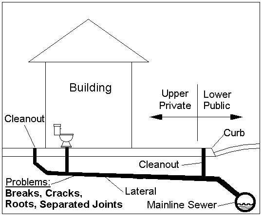

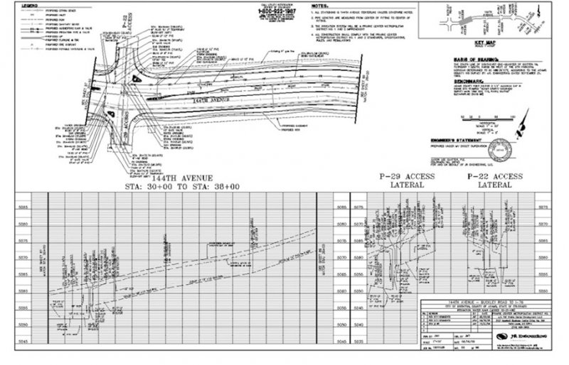

basty Posted August 7, 2018 Posted August 7, 2018 What is lateral in engineering drawing? Can someone please show me by an example? Thank you Quote

ReMark Posted August 8, 2018 Posted August 8, 2018 If it is a civil engineering drawing it is most likely referring to a sewer (sanitary) lateral with the source being a building of some type (residential, commercial, institutional, etc.). Quote

nukecad Posted August 8, 2018 Posted August 8, 2018 Yes, as ReMark and SLW210 say: Lateral pipework - joins the main run from the side. Lateral development - the development of the sides of a ploygon. More engineering laterals: Lateral access road - joins the main road from the side. Lateral conveyor - brings items to the main conveyor, from the side. Lateral drive (i)- a gearbox where an output is taken from the side. Lateral drive (ii) - a drive on the side of a drum that turns it. Not common in engineering but: Unilateral - on one side. Bilateral - on both sides. Lateral thinking - Considering a problem from a different angle/side. 'Lateral' is all about 'sides'. TBH though if you see the term 'Lateral' all on its own on a drawing then it's probably a pipe that feeds into a main (from the side). Quote
CyberAngel Posted August 8, 2018 Posted August 8, 2018 The civil plan from SLW might be the answer. Civil 3D explicitly calls that a plan & profile. The laterals, therefore, are profiles of lines that drain into the main line. The same tools work for sewers and storm drains. Quote
