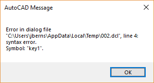

I ran the first example, but received an error. See attachement.
Otherwise, these appear to be useful examples. I really like the idea of on-demand DCL file creation. One less file to manage.
I have corrected the DCL error (that was my fault).
When running the first example, (ah:getval1 "Line 1" 5 4 default), this error results: "; error: bad argument type: stringp nil"

Good news, error resolved. I needed to change, default, to an actual string. For example, (ah:getval1 "Line 1" 5 4 "Test").
And, the temp file erased itself after the dialog closed. Automatic clean-up - terrific!!
