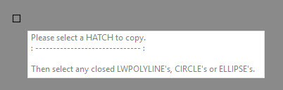

My work is mostly about loops and terminal connection diagrams so I rarely use hatch myself but it seems to work. Only thing I would change (which is just a matter of taste so feel free 2 disagree) and its just cosmetic , you give user both prompts for selecting hatch and the objects who want to be hatched at the same time. So my very first thought was , do I select pline or hatch first? But of course this is just for first use , next time you know... So not bad for an office tea brewer :-)

Thank you. I make more than just T!!
I've only just got to sort of understand LISP'ing.
I've taken your suggestion on board and added a princ for selection of objects.
The 1st entget prompts for the HATCH with the below onscreen display.
I wanted to follow the workflow of both getting HATCH inherit props. ssget can't have on-screen display prompts AFAIK.
Updated code above to v1.01. Slight bug with the background color getting overridden if that var is set.
