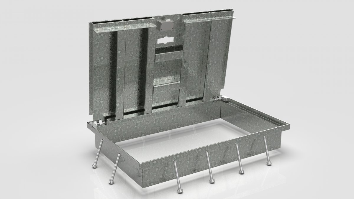

f700es Posted July 20, 2018 Posted July 20, 2018 How about using something else to render? I brought your model into SimLab Composer 9 (there is a free Lite version even for commercial jobs) and I applied 2 materials and hit "render". This was the result.... (about 5 minutes) Quote

Cad64 Posted July 21, 2018 Posted July 21, 2018 I don't see why they continue to included rendering in AutoCAD. There are so many better options at this stage of the game. Just remove it and be done with it. I've been saying that for years. Autocad is a great 2D drafting program, but in my opinion, it really falls short in the 3D department. As you said, there are much better options out there. That render from Simlab looks really nice for only 5 minutes. What was the image size and resolution? Quote
f700es Posted July 21, 2018 Posted July 21, 2018 It was rendered at 1920x1080 and cropped down a bit. I think AutoCAD is still a player in the 3D modeling game but just not for rendering. Now having said that I have seen some sweet ACad renders in my time. Quote

f700es Posted August 3, 2018 Posted August 3, 2018 Hey Bill, you scene is washout for some reason. I changed this by going to Libraries (bottom left) and clicking on Rendering and then Presets. I clicked and dragged on Default and dropped it into the scene. This got me to a normal render. Also your materials didn't seem to hold or work on this file. I click on the lid and it says "Diamond Plate" but I don't see it. How did you apply these materials, was it don it AutoCAD? If so they might not transfer. Did you download the extra materials for SimLab? If not go here and follow the instructions. Then you will have loads of materials to use. http://www.simlab-soft.com/SimlabArt/library/ I applied a Diamond Plate material from this library to your top and got this. Quote
