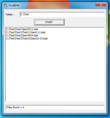

sandiegophil Posted July 17, 2018 Share Posted July 17, 2018 Hello, I am looking for a routine or program that will search a folder/tree or drive and find bak files that do not have a dwg by the same name. Any help is appreciated. thanks, Phil Quote Link to comment Share on other sites More sharing options...

maratovich Posted July 19, 2018 Share Posted July 19, 2018 (edited) Like this. It's not a lisp, not vba, it's an exe program. Program and test folder in the archive. programm.zip Edited July 19, 2018 by maratovich Quote Link to comment Share on other sites More sharing options...

maratovich Posted July 19, 2018 Share Posted July 19, 2018 I completely forgot that I started that back in 2011. I'm still looking for a solution to this... I have already given you a solution. Look at the post above. Quote Link to comment Share on other sites More sharing options...
sandiegophil Posted July 19, 2018 Author Share Posted July 19, 2018 maratovich, My reply was intended/directed at slw201, indicating to them that I had forgotten about the post from 7 years ago. I have not tried your solution yet. Quote Link to comment Share on other sites More sharing options...
