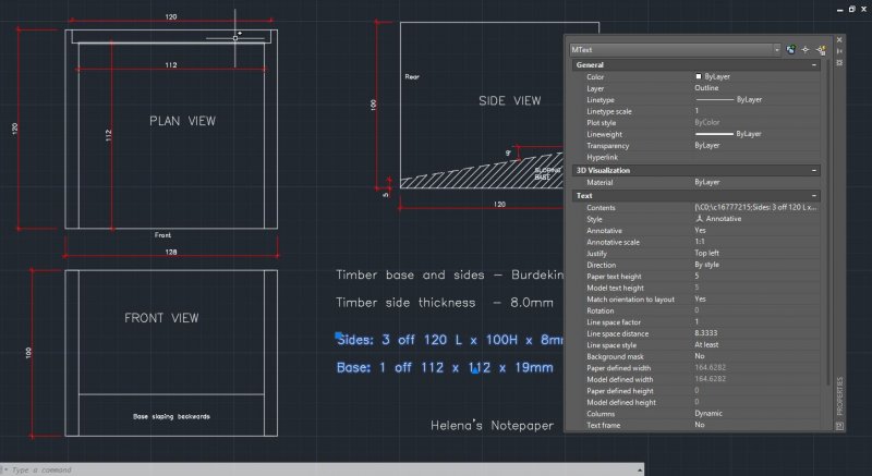

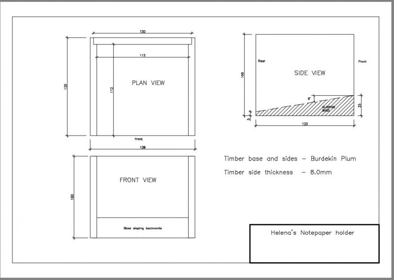

PJ01 Posted July 8, 2018 Posted July 8, 2018 (edited) In the drawing attached below, there are 4 lines of text shown above the title. The last 2 lines were added recently. When I print out the drawing from the Layout1 view, the last two lines of text ( specifying the dimensions of the sides and the base) do not appear on the printed output. Similarly, if I export the drawing in a .pdf format, the two lines of text are also missing. Also, the bottom two lines of text do not appear in the Print Preview. I have tried double clicking on the Layout1 page, saving again, zooming, shutting down and restarting the program, to no avail. Can anyone please advise why this might be happening, and how to overcome it? Helena_ Notepaper Holder.dwgFetching info... Edited July 8, 2018 by PJ01 Quote

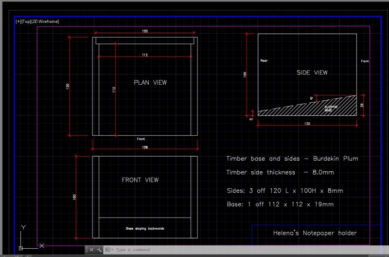

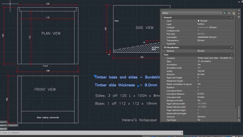

PJ01 Posted July 8, 2018 Author Posted July 8, 2018 (edited) Thanks for your ideas and suggestions, folks, I really apprecaite them. I have changed the colour to By Layer, and still the bottom 2 lines do not print. I have attached print screens of the various pictures which may shed some light: 1. Print Preview 2. Properties of the upper 2 lines of text 3. Properties of the lower 2 lines of text ( these were a separate multiline text addition, not an extension of the upper text) 4.The Layout1 view, showing Viewport boundary Edited July 8, 2018 by PJ01 Quote
Cad64 Posted July 9, 2018 Posted July 9, 2018 As Eldon mentioned, your Mtext is set to color 255,255,255, see image below. Double click on the Mtext, highlight all the text and then change it to ByLayer where I have indicated within the red box. Once you do this, your Mtext should change to red and you should see it when you plot. Quote
PJ01 Posted July 9, 2018 Author Posted July 9, 2018 (edited) Many thanks for doing this, Cad64, very much appreciated. As you can see in the post immediately before yours, I had changed things from my original .dwg posted by using the Outline layer ( not the red Dim layer) and changed the Mtext by selecting the two lines of text, going into Properties and changing the Colours to By Layer. Obviously that did not work, as I still could not see the 2nd row of text. Strange!! In the end I changed it in the Text Editor as you indicated, and the two lines of print appeared in Print Preview. YESS!!!!! All this problem printing lines came about because I entered the lines of text while in the Dim layer Edited July 9, 2018 by PJ01 Quote
eldon Posted July 9, 2018 Posted July 9, 2018 If you look at the Content section of the properties of the affected text, you can see some format statements before the actual text {\C0,\c16777215; That gives a clue that something is amiss. Quote

Cad64 Posted July 9, 2018 Posted July 9, 2018 PJ01 said: Thanks everyone, I have learnt lots from this, although I still don't know why changing the Mtext Properties of the selected lines of text did not work. It didn't work because the color property was overridden in the text editor. I know, it's a little confusing. You can set your layer color in the Layers palette, and you can override the layer color by changing the object color in the Properties palette, but then you can override the override in the text editor. Quote
