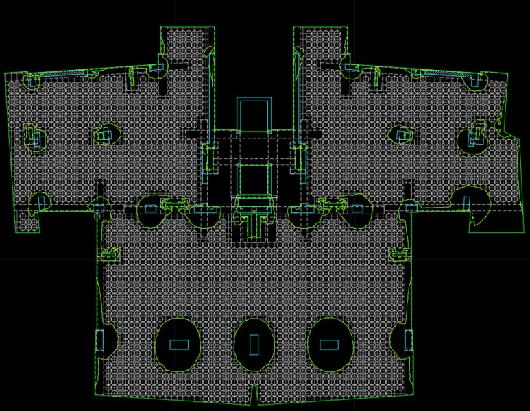

Hi guys, I've found and modify an old code that fit my needs.
EDIT: GP_ has originally written the starting code. thanks for tolding me, I really didn't know it.
You can find the original code here:
http://www.cad3d.it/forum1/showthread.php?38359-Disegnare-cerchi-all-interno-di-un-polilinea/page2&p=319854#post319854
Unfortunately sometimes it's very slow..
I'm here to asking if there is a better way to accomplish that result :D

I'm using OPENDCL so you can't run the code without some changes (I'll do them if needed).
The idea here is to create an hatch, explode it and insert a circle in the intersection points. If the circle cross a boundary line it will be deleted.
As you can see it's very slow...
Thanks for your help!

What do those circles represent?
Hello!
They represent the position of void former modules for lightweight reinforced concrete slabs.

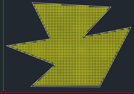

A simple method select pline that represents the inner boundary use bpoly if required. Boundary box the pline choose a start point for what I used as the first circle location, in my case it was concrete panels, array in x and Y so it covers all of the pline, go slightly bigger than the pline, it is then very simple to clip/trim all the outside circles removing them, redo trim again this time any circles touching the pline get erased. This method was used on plines with arcs.
You need a bit of layer control so when doing trim don't wipe out something that should remain. It is very fast code was written originally like 20 years ago so pc were not that fast then. Its one bit of code I don't have as its copyrighted and I need to redo it anyway. I think I used chprop on objects that were found within poly "WP" so outside was like layer1 inside layer2 just del layer1 after change
I would also look at using UCS picking a side etc to orientate would be maybe more economical in ball placement.
I did manually all the steps in a new lisp that has not been coded yet.
circle
array circle
chprop wp picked the inside points and changed layer
layiso outside circles and erased
unlayiso
all done.
Ps arcs can be taken into account by making facets when doing Chprop WP to increase accuracy.
This is version 1 I have to add a few things and make faster, it just needs a pline to work, so if you have the objects in the image just use bpoly to make a internal pline that will be asked for note arcs are ok in a pline. Its a bit slow but I made a few thousand circles when testing. I need to add the control point correctly, I expect you would pick a side as a square off for the mesh so do Bpoly and UCS OB before running. Needs a trans function ver 2.

Had to blink a couple of times (with my eyes) how does it work , but then the light went on :-) Probably more roads to Rome but I think you did a great job Bigal! :beer:
Working on the UCS version now, as its concrete with reinforcement, there would be an edge that you start with, the other item is that you nominate the starting point for the circles, in the image above you have say reo at 200x200, a ball then every 200mm so need a start point that defines the grid pattern. Also looking at entmake as array is very slow and not sure why compared to manual. Found a hiccup that bounding box must be translated in a UCS. Found the code for translate and its very long. So looking at just using a min-max routine on the pline instead as it will work within the current UCS.

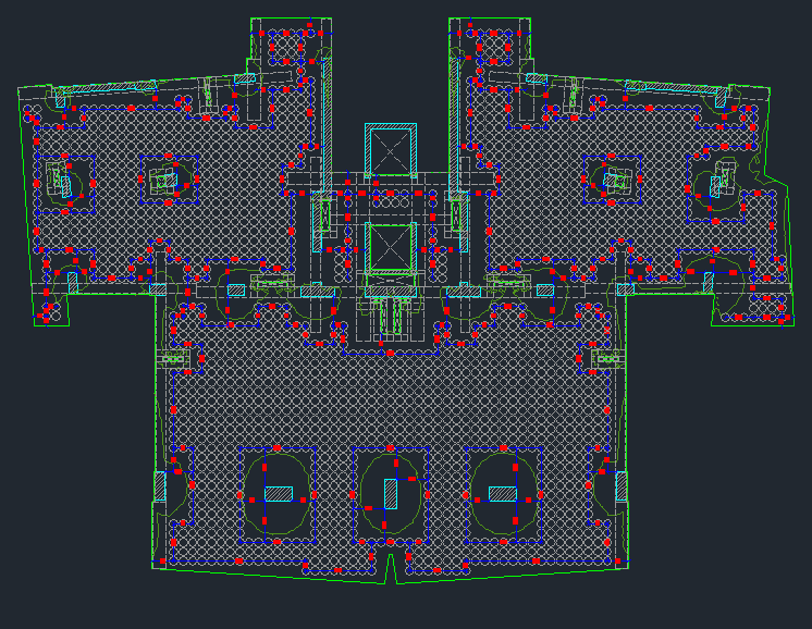

HERE's a quick stab at it using an exploded net hatch ( lines ) and other objects that are NOT lines. Not sure about speed but works with islands.
Definitely not that fast:
Command:
Command: QS
Filter by [blockName/Entity/Layer/Xdata] : l
Select object to set layer [HATCH]:
Select items on layer VOID...
Number of objects in selection: 6382
Couple of tweaks :)
Command:
Command: QS
Select object to set layer [VOID]:
Number of objects in selection: 26516
Edited by ronjonp

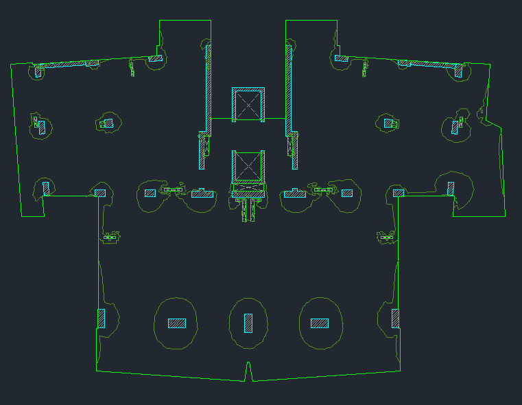

These elements can not be placed anywhere but only in areas where the shear strength of the floor is not exceeded.
These areas can be seen in the example and are those outside the green line. In cyan with the grey hatch you can see the supports of the slab and also above them you can not obviously put them. My code somehow takes it into account (sometimes it fails) just by creating the hatch. Perhaps an idea could be to create an hatch and use its boundary as a polyline instead of selecting it?
Anyway it's 50x faster then mine :D
Edited by MastroLube
I think it may be a couple of extra steps involved Bpoly will make plines of every shape within an enclosed area so it would put balls every where in the random shape including I take it the squiggly green line as the limit rather than the blue rectangs then second step would be select all green wiggles inside big polygon and repeat the ball trimming. Is that whats wanted or am I not understanding correct.
Hello Bigal!
Thanks for the explanation. Sound very cool that extra steps of Bpoly could do the trick! :)
Unfortunately green lines are not a polyline and usually it's on an XREF. It's what comes out of my fem (AxisVM).
Anyway yes, it's exactly what i'm dreaming for :D

Can you post that DWG?
Here's what I have so far .. perhaps you can tune it to your needs.
