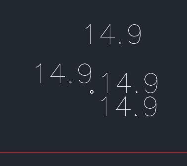

Any way had a go BUT ! the dwg has some problems see image below, text is repeated so its not perfect.

I notice a lot of doubles: 2 or 3 texts per circle.
Anyway, they get put one on the other.
