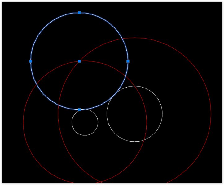

Or 1st principles how to work out the center of the 3rd circle offset the two existing circles by the radius of the new circle where they cross is the center point.
