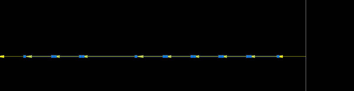

hello, any one can help me make multiple leader match same angle
On 6/21/2018 at 9:56 PM, hanhphuc said:
1.If the Mtext is associative to Leader's end, just move it or modify x-coordinates properties.
2.lisp: same method from my previous code, by subsituting middle point (cadr p)
now just modify the end point (last p)

p/s: if you've learned then you can combine all 3 in 1 :)
Thanks mate, your code work like a charm for me. But it only do with leader has 3 points, can you modify it working with 2 points ?. I has been struggled with leader, is there any code to extend leader (second vertex point or last vertex point, landing in a point) like extend a normal line by choosing an edgeimage.thumb.png.1eec32e864542bfd3c5ba3d2d366d5c7.png

maybe you edit (assoc 75) value 0 to 1 (hook flag)

how can I make all the leaders to only 90° ,180°, 270° ,360°
(Points to points only orthomode, like 90°,180°,270°,360°)
as attached drawing

Your code takes the first point of an existing leader and creates a three-point leader using the underlined start and underlined end of the text.
To make this perpendicular, you would fix the first and third points and move the second point toward the right angle.
Since there can be two points that are perpendicular when two points are fixed, (rectangle)
You need to find a right angle point located on the extension line from the previously calculated second point.
