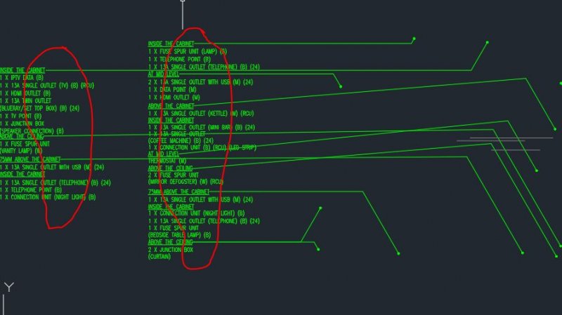

mikewong0719 Posted June 20, 2018 Author Posted June 20, 2018 one more question, any method can make leader height is follow leader end point and is a straight line , like to this photo Quote
hanhphuc Posted June 20, 2018 Posted June 20, 2018 hi read this about code tags before [NOPARSE] your code here [/NOPARSE] after your code here Marko also commented one more question, any method can make leader height is follow leader end point and is a straight line , like to this photo (defun c:test ( / s e p i a ) (if (setq s (ssget ":L" '((0 . "LEADER") (-4 . "&=") (76 . 3)))) (repeat (setq i (sslength s)) (setq e (ssname s (setq i (1- i))) p (mapcar 'cdr (vl-remove-if-not '(lambda (x) (= 10 (car x))) (entget e))) a (angle (car p) (cadr p)) ) (vlax-put (vlax-ename->vla-object e) 'coordinates (apply 'append (subst (polar (car p) a (abs (/ (cadr (mapcar '- (car p) (caddr p))) (sin a)))) (cadr p) p ) ) ) ) (princ "\nNothing?") ) (princ) ) Quote
mikewong0719 Posted June 20, 2018 Author Posted June 20, 2018 (edited) NOW THIS LISP IS WORK , BUT ONLY CAN MAKE ANGLE ,BUT LEADER SECOND LINE HAVE A PROBLEM , HOW CAN SOLVE?? pls (defun c:foo ( / mtchleader ss a i lea p1 p2 p3 mp ) (vl-load-com) (while (or (not (setq mtchleader (car (entsel "\nPick matching leader - matching angle of this leader is reference angle for all other leaders...")))) (if mtchleader (/= (cdr (assoc 0 (entget mtchleader))) "LEADER") ) ) (prompt "\nMissed or picked wrong entity type...") ) (while (or (prompt "\nSelect leaders to match...") (not (setq ss (ssget "_:L" '((0 . "LEADER"))))) ) (prompt "\nEmpty sel.set...") ) (setq a (angle (cdr (assoc 10 (entget mtchleader))) (cdr (assoc 10 (cdr (member (assoc 10 (entget mtchleader)) (entget mtchleader))))))) (if (ssmemb mtchleader ss) (ssdel mtchleader ss) ) (repeat (setq i (sslength ss)) (setq lea (ssname ss (setq i (1- i)))) (setq p1 (cdr (assoc 10 (entget lea)))) (setq p2 (cdr (assoc 10 (cdr (member (assoc 10 (entget lea)) (entget lea)))))) (setq p3 (cdr (assoc 10 (reverse (entget lea))))) (setq mp (inters p1 (polar p1 a 1e-2) p2 p3 nil)) (vlax-put (vlax-ename->vla-object lea) 'coordinates (apply 'append (list p1 mp p3))) ) (princ) ) Edited June 20, 2018 by rkmcswain Added [CODE] tags Quote

hanhphuc Posted June 21, 2018 Posted June 21, 2018 PLEASE HELP ME , I REALLY NEED THIS LISP, because MY DRAWING have a lot of leader but leader angle not same , but my job need to arrange all leader make same angle, how can i do ??I only need same angle, no need same height hi, IMO it's time to learn coding possibly the solutions ? 1. match leader angle using (c:foo) - by Ronjonp or Marko 2. optional for same height, perhaps equal spacing method ? 3. To fix straight to end, (c:test) previous post#22 Quote

hanhphuc Posted June 21, 2018 Posted June 21, 2018 I DON'T KNOW HOW TO REVERSE THE LISP, CAN U HELP ME??pls i tested Ron's (c:foo) , it fixed the angle, ok Quote
mikewong0719 Posted June 21, 2018 Author Posted June 21, 2018 IT OK NOW , but i have one more question, any method can make leader last point is same , like to this photo Quote
ronjonp Posted June 21, 2018 Posted June 21, 2018 If you start using mleaders ( which I strongly suggest you do ) the mleaderalign command will do that easily. Quote

hanhphuc Posted June 21, 2018 Posted June 21, 2018 IT OK NOW , but i have one more question, any method can make leader last point is same , like to this photo 1.If the Mtext is associative to Leader's end, just move it or modify x-coordinates properties. 2.lisp: same method from my previous code, by subsituting middle point (cadr p) now just modify the end point (last p) (defun c:test ( / s e p i a ) (if [color="red"](and (setq x (getpoint "\nPick side to extend "))[/color] (setq s (ssget ":L" '((0 . "LEADER") (-4 . "&=") (76 . 3)))) [color="red"])[/color] ... ... ... (apply 'append [color="red"] (subst (cons (car x) (cdr (last p))) (last p) p )[/color] ) ... ... p/s: if you've learned then you can combine all 3 in 1 Quote
